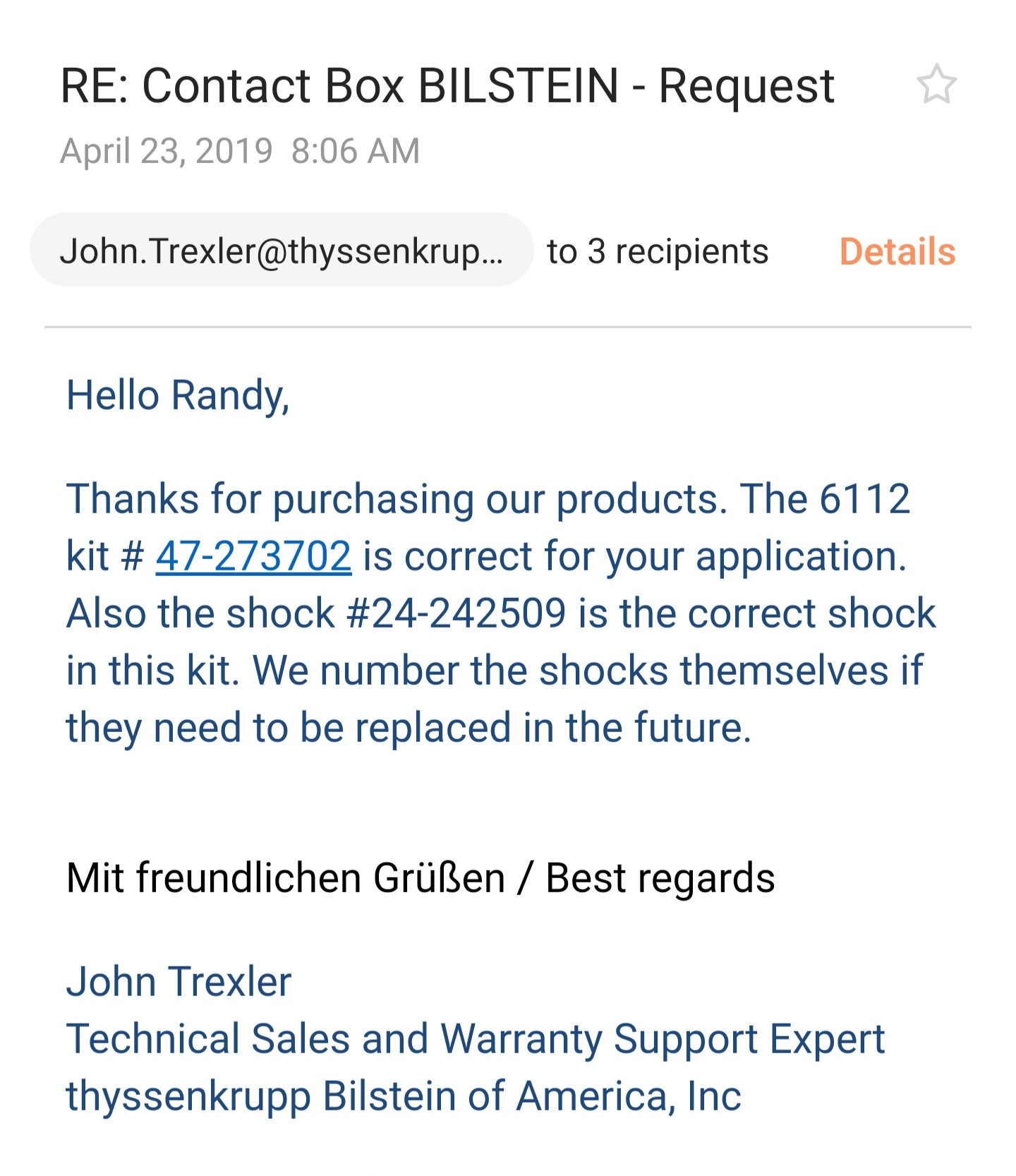

I received my Bilstein 6112 47-273702 shocks today and you were right, these shocks are huge. I placed my order on 3/28/19.  The part number on the box has me questioning if I received the correct product. It looks like the right product, but the part number on the box is 24-242509.  Is that what you received as well?
I'm getting rid of the factory magnetic shocks because they're way too stiff and replacing it with the 6112's and 5160's in the rear. I'll be removing the rough country 2.5" lower spacer and installing the 6112's at the top setting. If my truck isn't level after, I may install a half inch lower spacer to even it out. I'm using the x-ineering delete kit to get rid of any alarms. I'm looking forward to a smoother ride. Those magnetic shocks are way too jarring driving on rough roads. I'm hoping to have mine installed by Saturday morning.
Thanks for sharing that you received your shocks.
After I saw you're post I check my part number and I have the same number as you,  24-242509. Did you confirm this is  the correct part number?
Thanks for getting back to me with that. Yes, per Bilstein that part is the correct shock number.

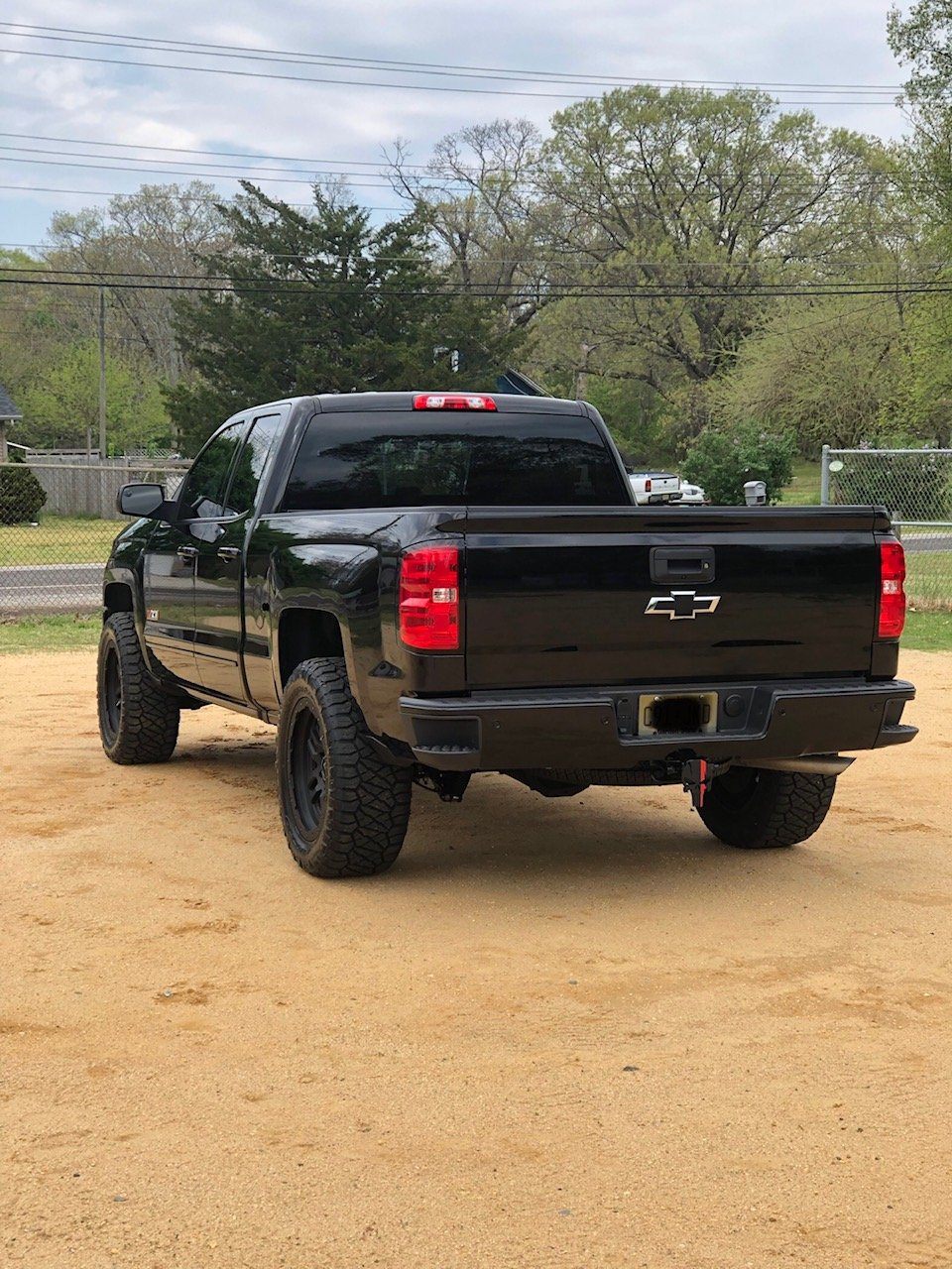

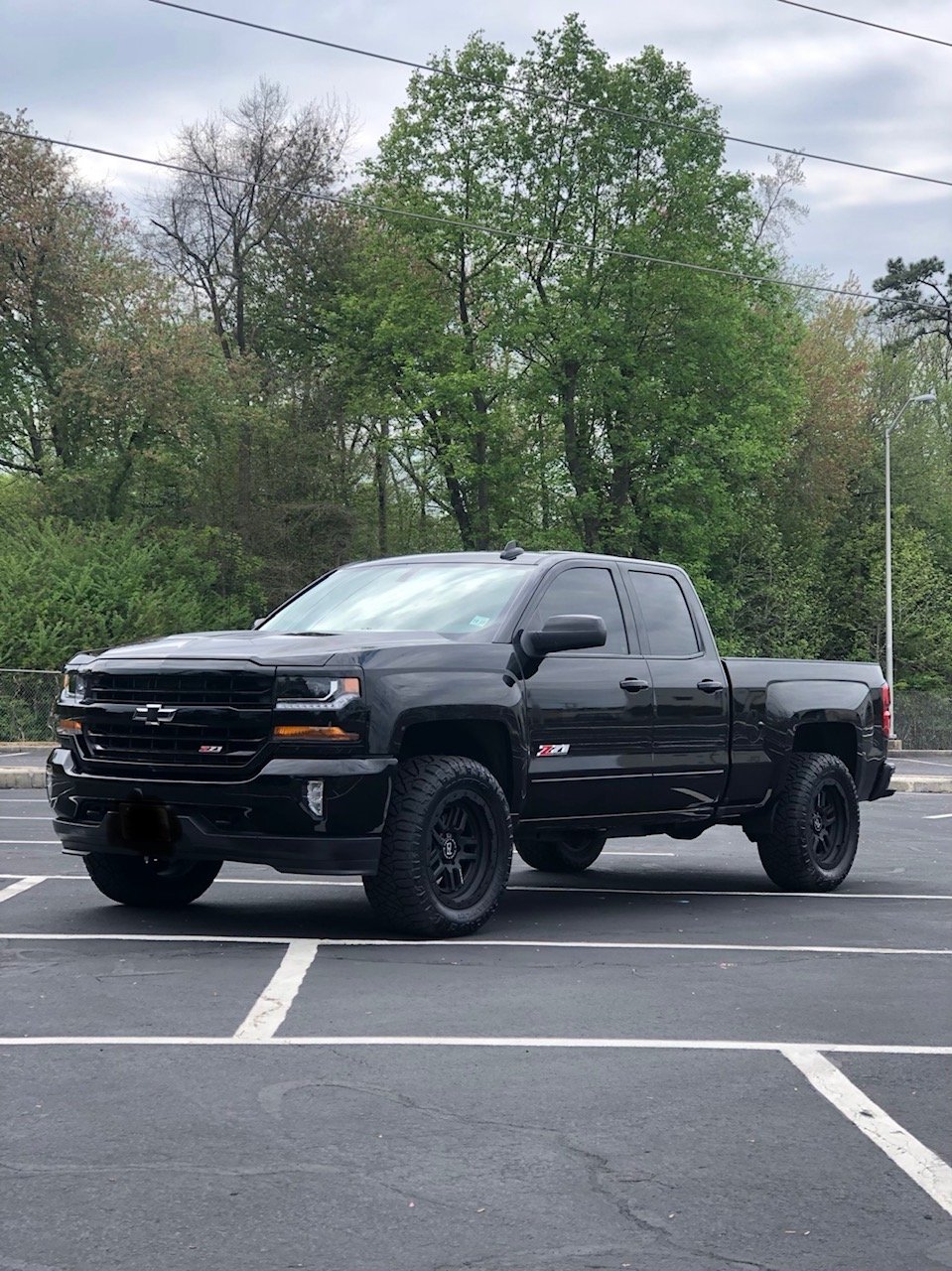

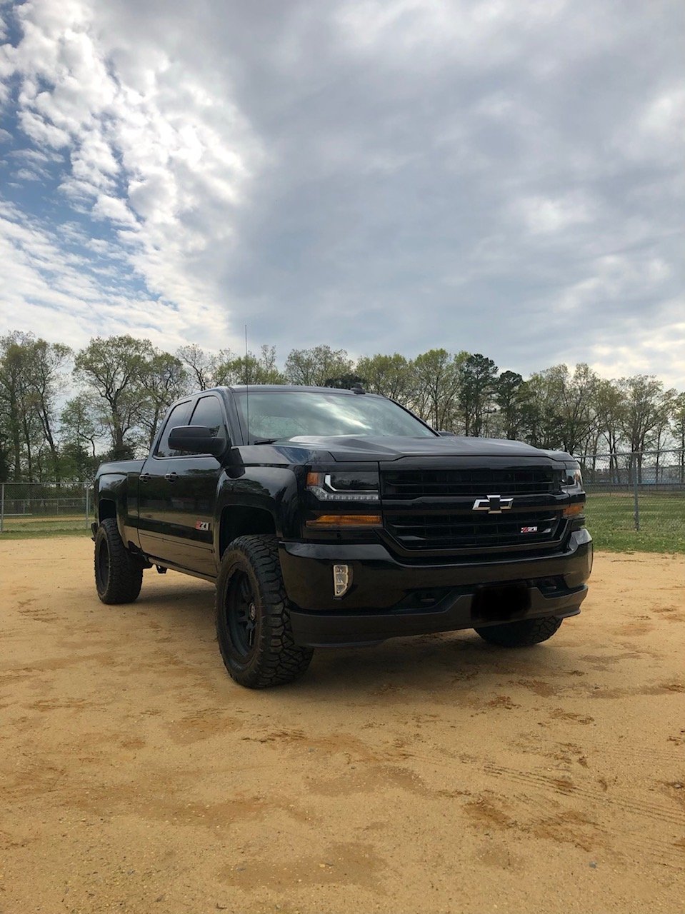

Gentlemen,
              Sorry for the late reply as I've had these installed for well over 2 weeks. I've attached some pictures. The truck was completely leveled with the Bilstein 5100s at the highest setting. Front and rear it was spot on.
Some notes:
  • As others have said, take your old strut assembly somewhere to get them swapped. We had a hell of a time. We tried a floor mounted spring compressor to no avail, and the rentable threaded rod tool also. I ended up giving up and taking them to a local shop. Much easier, cost around 45 dollars.
  • The rear installation took about 15 minutes on a lift. Super easy as expected.
  • The ride has improved so much from the stock Ranchos. Those things are garbage. With the wider stance the truck feels much more stable as well.
  • This setup rubbed at about 3/4 to full turn, and reverse was almost un-useable. I went and bought the Rough Country Fender Trim pieces and broke out the angle grinder. This was much easier than I thought it would be, and now i have ZERO rub. Full lock turn, full lock reverse. Can't even tell I did it. I saw people doing the NorCal mod but for 17 dollars, the trim plates seemed like the way to go.
  • This setup is great. Rides great, looks great. I might go with a 4" Fabtech sometime next year. I'm not quite sure. I'm so happy with the ride quality i'm not sure I need to do anything different. I would only consider it to lift the truck up a bit more.
  • The next day I took my truck to get aligned as it was off pretty bad. I highly suggest getting this checked after doing the install.
2018 Chevrolet Silverado Z71 Midnight Edition
Tires: Nitto Ridge Grappler 305/55r/20
Wheels: Black Rhino Barstow Matte Black 20x9.5 -18 offset.
Edited by z71skywalker
