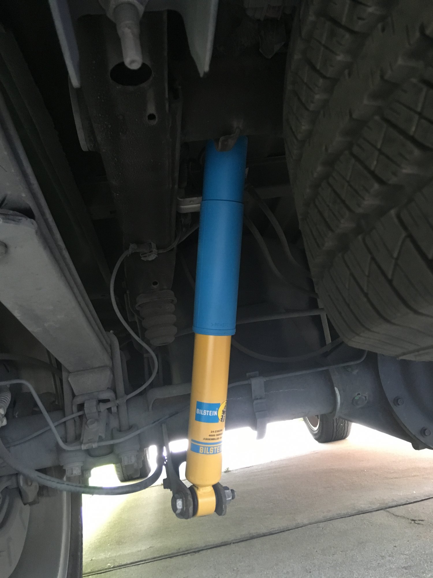

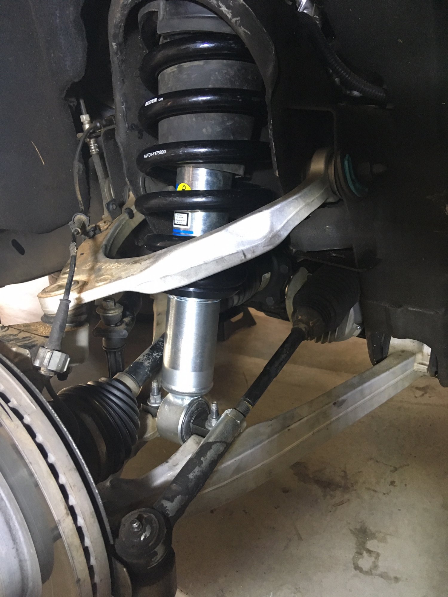

IMG_3262.thumb.JPG.b8976cf3d985254088aad12bdf7c023c.JPGIMG_3268.thumb.JPG.c92a921abbee5e15e40ef2838f404195.JPGIMG_3267.thumb.JPG.caea5c88e42abc967e0f7d0c80e44d7d.JPGI just got done with installing my 6112's on my 2014 GMC Sierra Crew Cab.  Reading some install guides on here really helped, along with printing some Chilton Repair guide torque specs that I got from my local library's online account.  I think the hardest part was getting the new assembly into place, but using a pry bar to help lift the new unit up by the springs against the upper control arm, it eventually got into place and bolted on.  I only lifted my truck 0.5" (1 rings space up from stock height).  So far I've only driven around my neighborhood, about 1 mile.  No problems at all so far.  I hit a few bumps that would normally give me a bouncy rebound, and the recovery now is more plush and controlled.  I'll have to spend some more time with it and give a follow up.  But so far so good.  Took just over 3 hours to complete the install too with 2 sets of hands working.
Edit Updated +1 day:  After driving for about 15 miles now, the comparison to stock is a huge improvement in ride over any condition.  I am surprised that its not just how much better speed bumps feel (which is night and day different), its even freeway driving and smooth dips at 70mph where stock felt like you rebound too high/fast and loose adherence to the road, and now its more controlled.  I can't wait see what the difference feels like on bumpy dirt roads where I would be tossed around before.
Results sound similar to the 5100 over the lackluster factory Rancho.
Man those 6112's are beefy. Too bad they do not make a rear as well.
