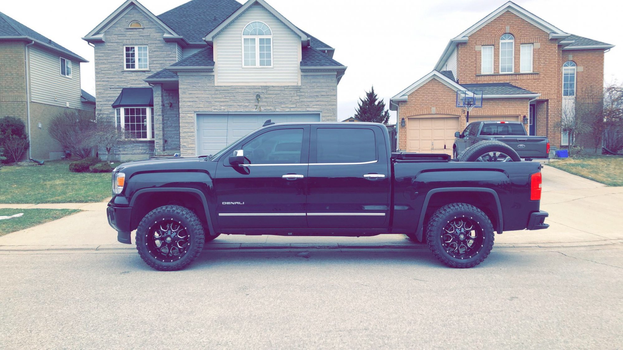

Well I thought I would post an update..
I decided going with a 2.5” level in the front.. and ended up getting a sweet deal on new wheels and rubber that I couldn’t turn down..
heres a pic of her now! Very excited and turned out better than I expected!! It’s squatting a bit in the rear with the oem wheels in the back lol once they were out it was back level lol
