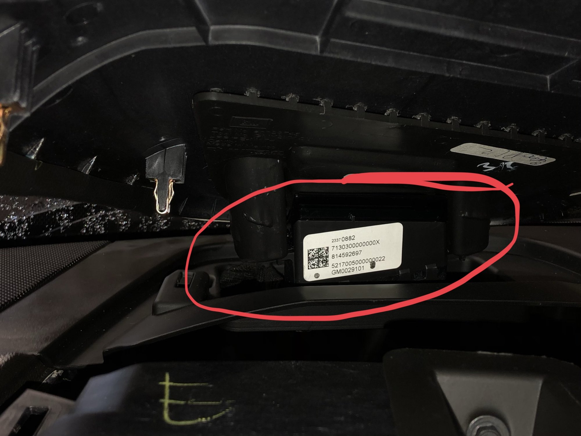

Question:  My Cluster came back to me today from Chris and I went to install it.  When I attempted to take the visor off I noticed it was attached to something.  There is a cord attached to a little black box going into the visor that prevents me from removing it completely.  Anybody have any idea what this is and what to do about it?  I'm driving a 2017 Yukon SLT.  Thanks!

6 minutes ago, RACERX7775 said:
So you have heads up display. Is your new cluster programmed for it?
Is that what that is?  No. I don’t have the controls for a heads up display anywhere.  Do I need to unhook this before I can proceed?
that is the FCA (Forward Collision Alert) light module
you can unplug it to remove the cluster
__If you add the HUD, it would replace this device entirely
Edited by migizi
Beat me to it.
Ohh ok. Jeez I have no clue on how to disconnect it.
like most automotive connectors, you need to depress a tab on one side and pull
your going to have to get in a bit closer and look

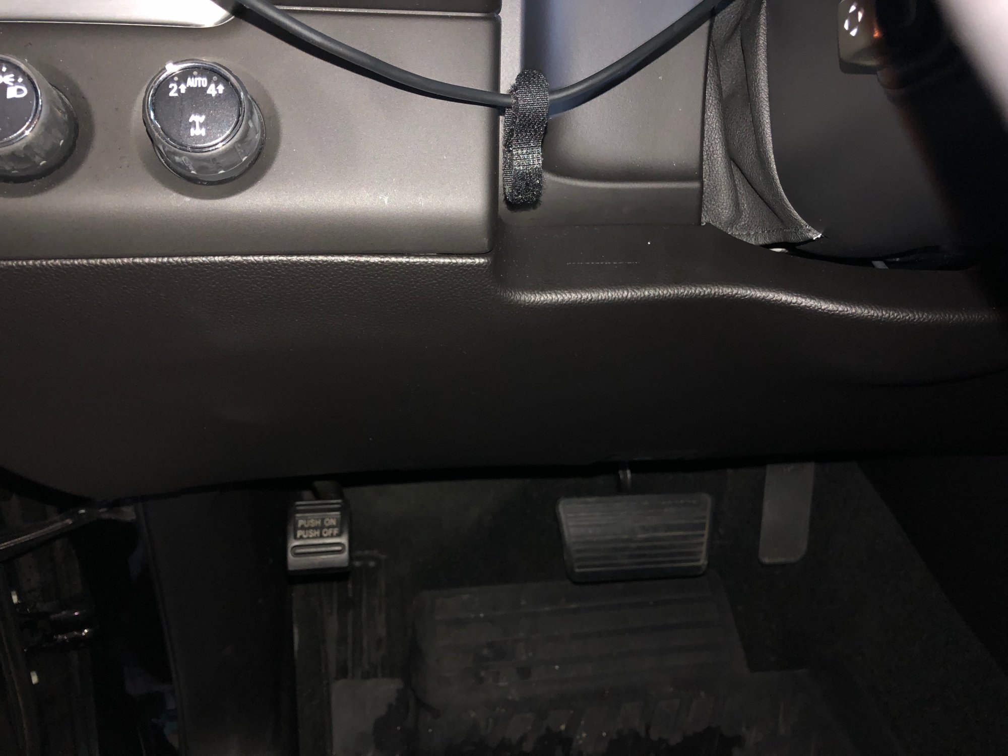

Last question, and I apologize in advance.  The bottom portion of my vehicle is slightly different than the ones in the installation videos.  Mine is all one giant piece.  Would anyone know if this entire piece should be popped out?  I don't want to damage anything but I don't see any other way to get to the cluster as some of is behind this large piece.

Is there a panel under your steering column that has the hood release? On the Sierra it’s held in by 2 torx15 screws. If you do, lower that and see if there is something else you might be able to see holding it up??? Just trying to help since I have no idea how the Yukon is put together. I bet you’re not the first to do this on a Yukon...maybe someone can chime in who has and they just haven’t seen your posts. Good luck, sorry it’s being a pain.
I certainly appreciate the help.  There is one large panel that stretches the entire length of the driver seat.  It’s the photo I posted above.  I’m not sure if it would need to be removed as its not a smaller piece like I’ve seen in the truck videos.  This piece literally stretches from the door to the middle console.
So there were two bolts holding the plastic piece in on the outside of the cluster?
Not holding that part but by dropping the lower panel it frees up a plastic piece that helps hold that piece in place.
