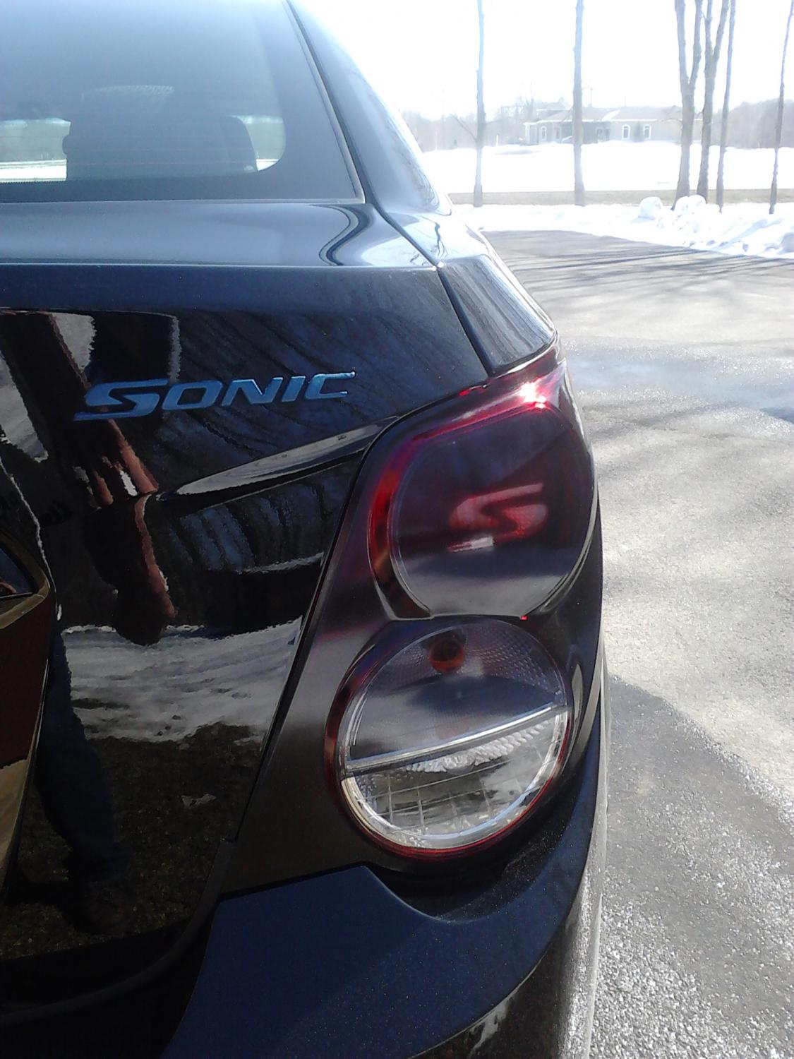

Haven't done it to my truck yet, but I did on my last sedan
VHT Nightshade as dark as I wanted, then I did quite a few coats of a glossy enamel to keep them from fading and wearing down (washing the car and rain wore them down the first time I did them)
I ended up redoing them a 3rd time before I sold the car to make them darker, but I don't have any pictures of that

I did my '05 with VHT Nite Shades. I don't have a picture of it but just be careful not to get runs in the paint. I never clear coated mine and they lasted well over three years with no issues.
Please just use a tinted clear vs VHT. It will hold up way better and looks a ton better. I can't stand that flat black look on the lights. It looks unfinished to me.

I've used VHT a couple times before with awesome results. Note the job, after it's dried will need to be polished with buffing compound to make it look factory. Otherwise it'll look coated.

I tinted mine. You can see through it the same as a tinted window.
I may have them painted later on, but I wanted to keep it removable in case I move to a less friendly state / area. Is it possible to remove the paint if a body shop paints the lights? The 2016 SLT LED tail lights are really pricey if I had to replace them to remove the tint / black.
Automotive clear coat and add a few drops of black to tint it. Spray with a hvlp gun and do your desires amount of coats for darkness.
Another good note here. After I did my '05 it had a grainy/tacky feel to it. If I would have buffed and polished it, it would have looked perfect.
