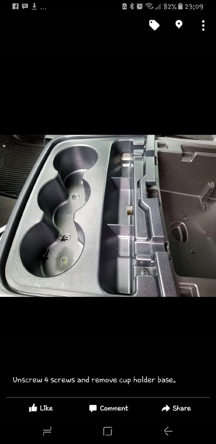

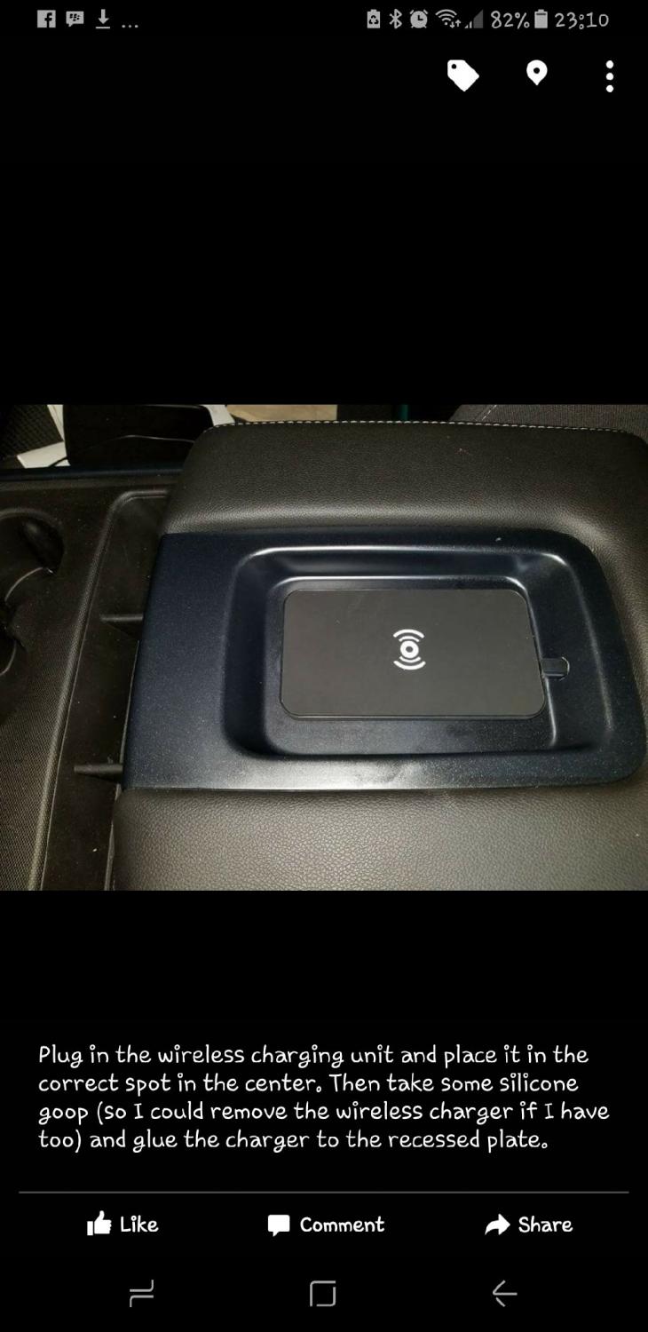

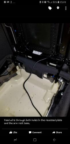

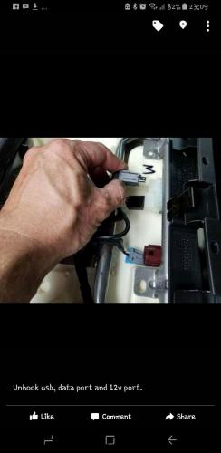

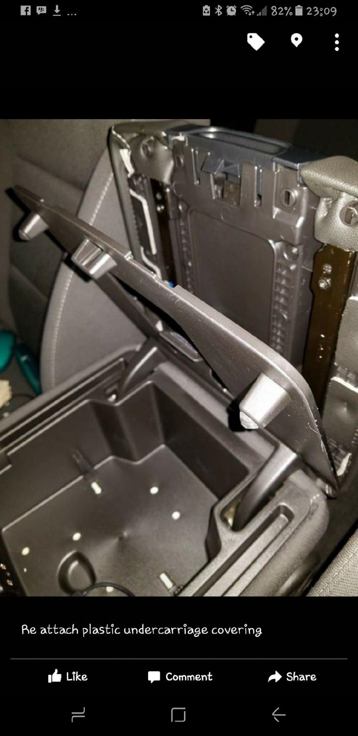

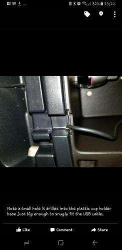

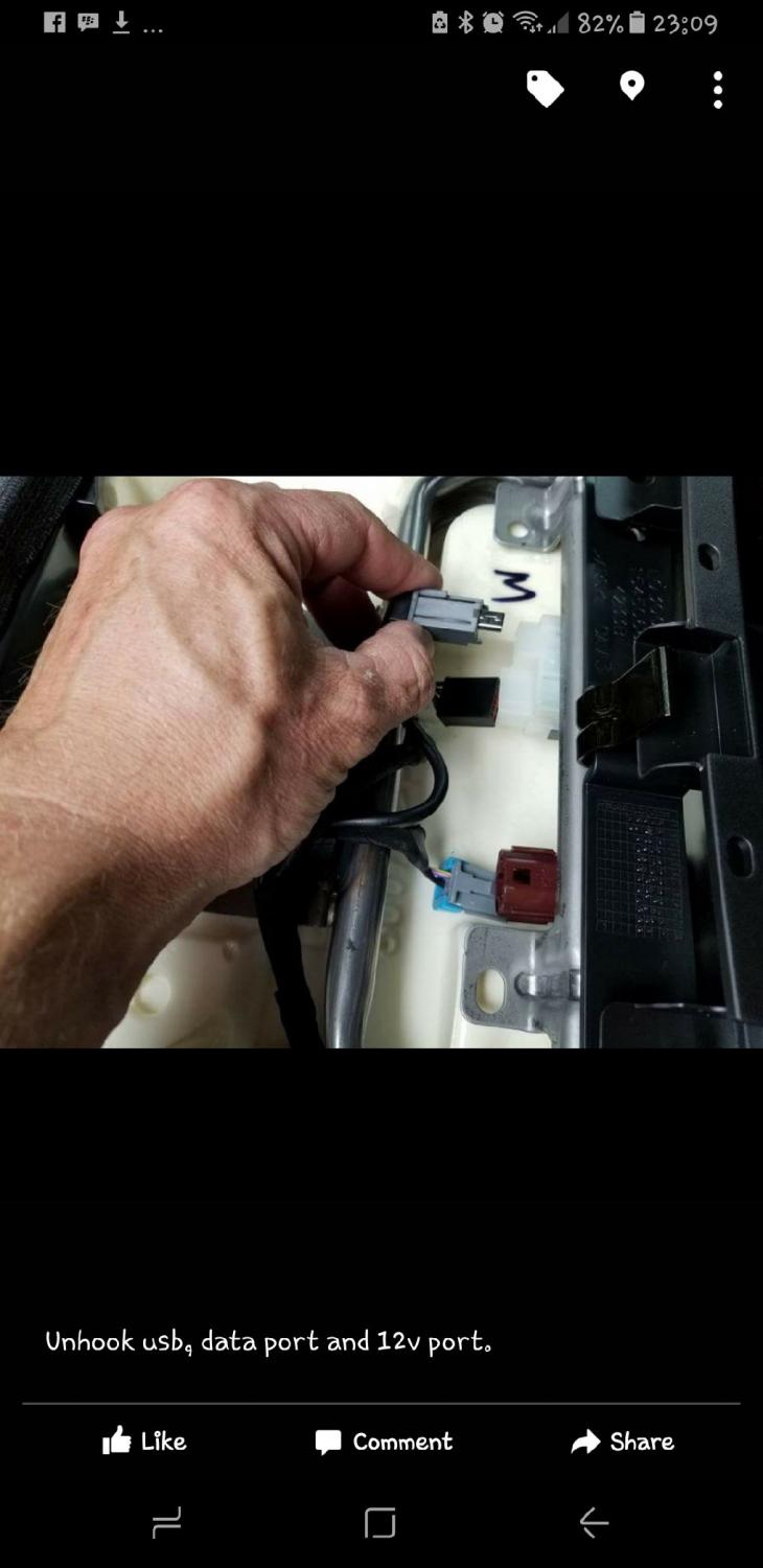

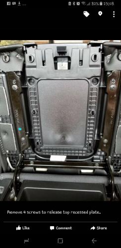

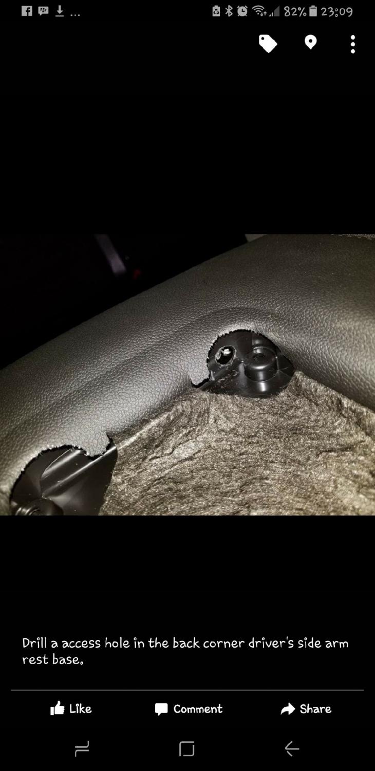

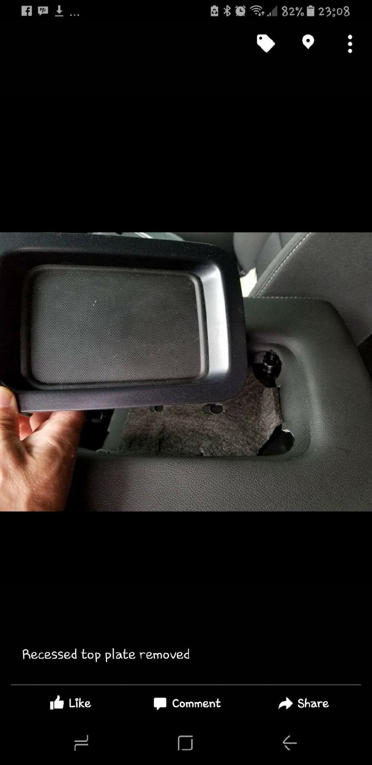

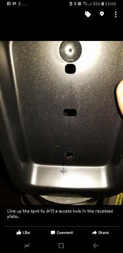

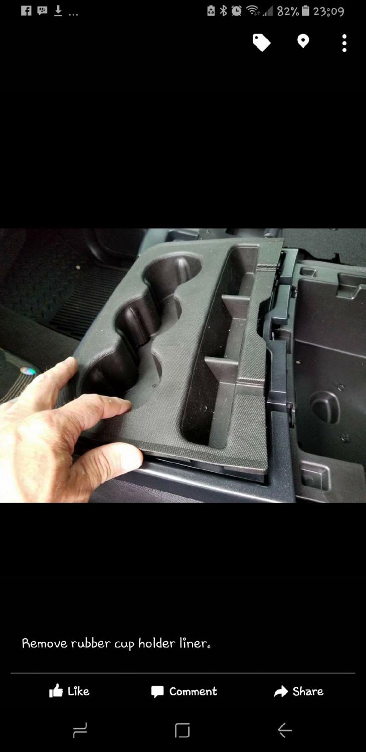

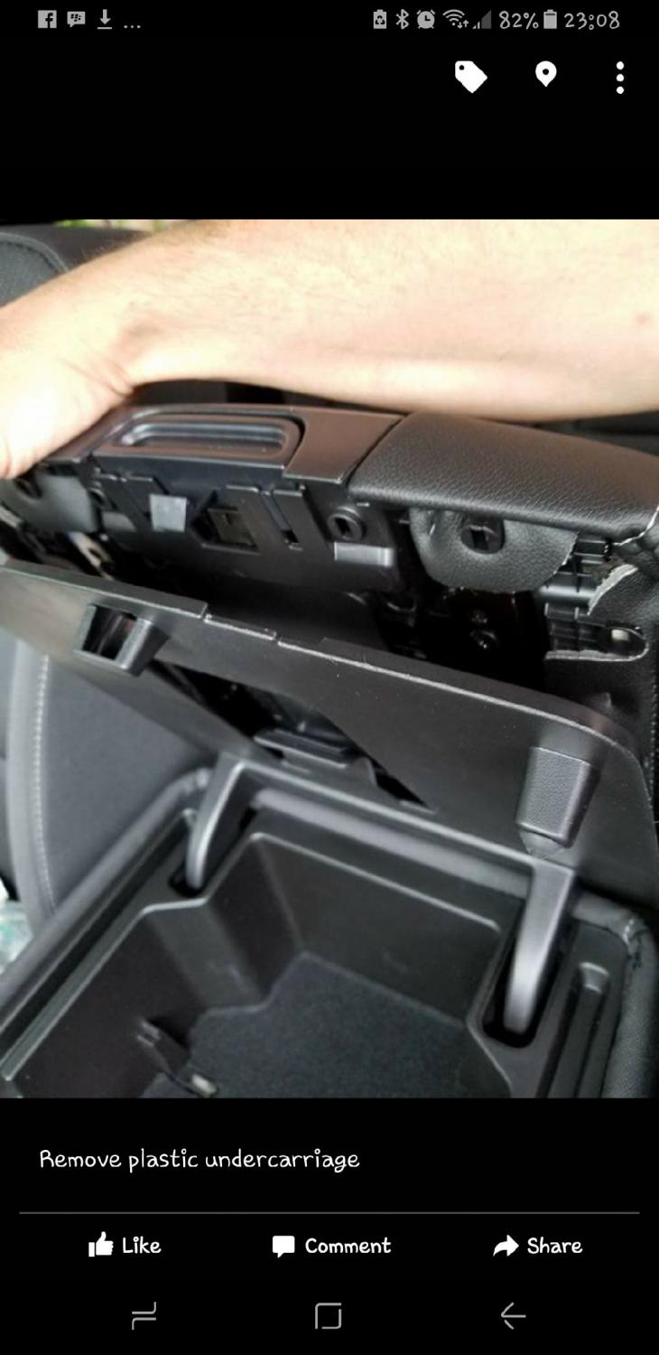

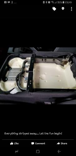

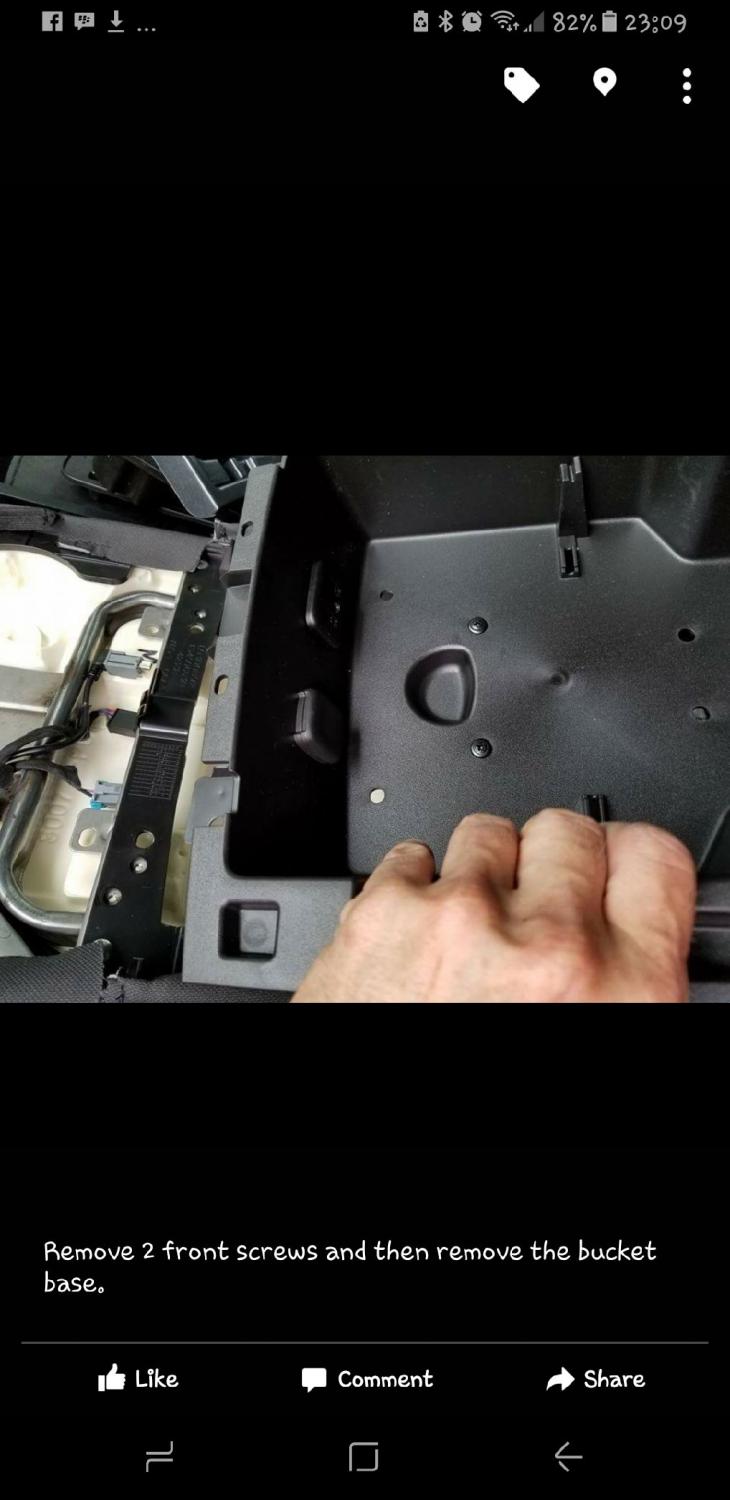

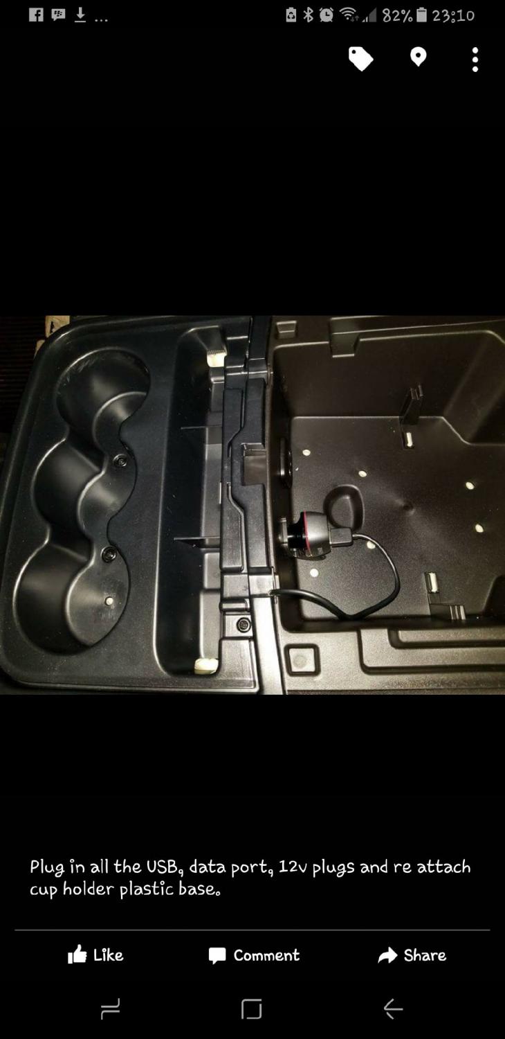

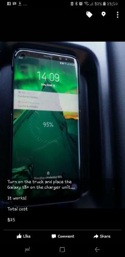

Adding a wireless smartphone charger to the center arm rest
Modifing my new 2017 gmc sierra pickup truck to install a wireless smartphone charger in the arm rest...

I have the wireless charger on my LTZ, and I've only used it once to test it out.
My phone is always plugged into the the USB port to use Android Auto, so wireless charging is useless for me. Now... it they finally somehow get Mylink to work wireless for AA, then I can see where I would use the wireless charger more often than plugging it into the USB port...

Probably about the only time you'll get that thing to work, ONCE!!
Mine is garbage. I've had it work a few times, but other than that its very finicky.

Yah, I haven't tried again since then. But I've heard it's finicky on phone placement and type.. lol
it was a feature I really didn't care for due to the placement of the charger on the center console. Up front would have been better, I've flipped the the lid and wife's phone goes flying to the back.. :D
