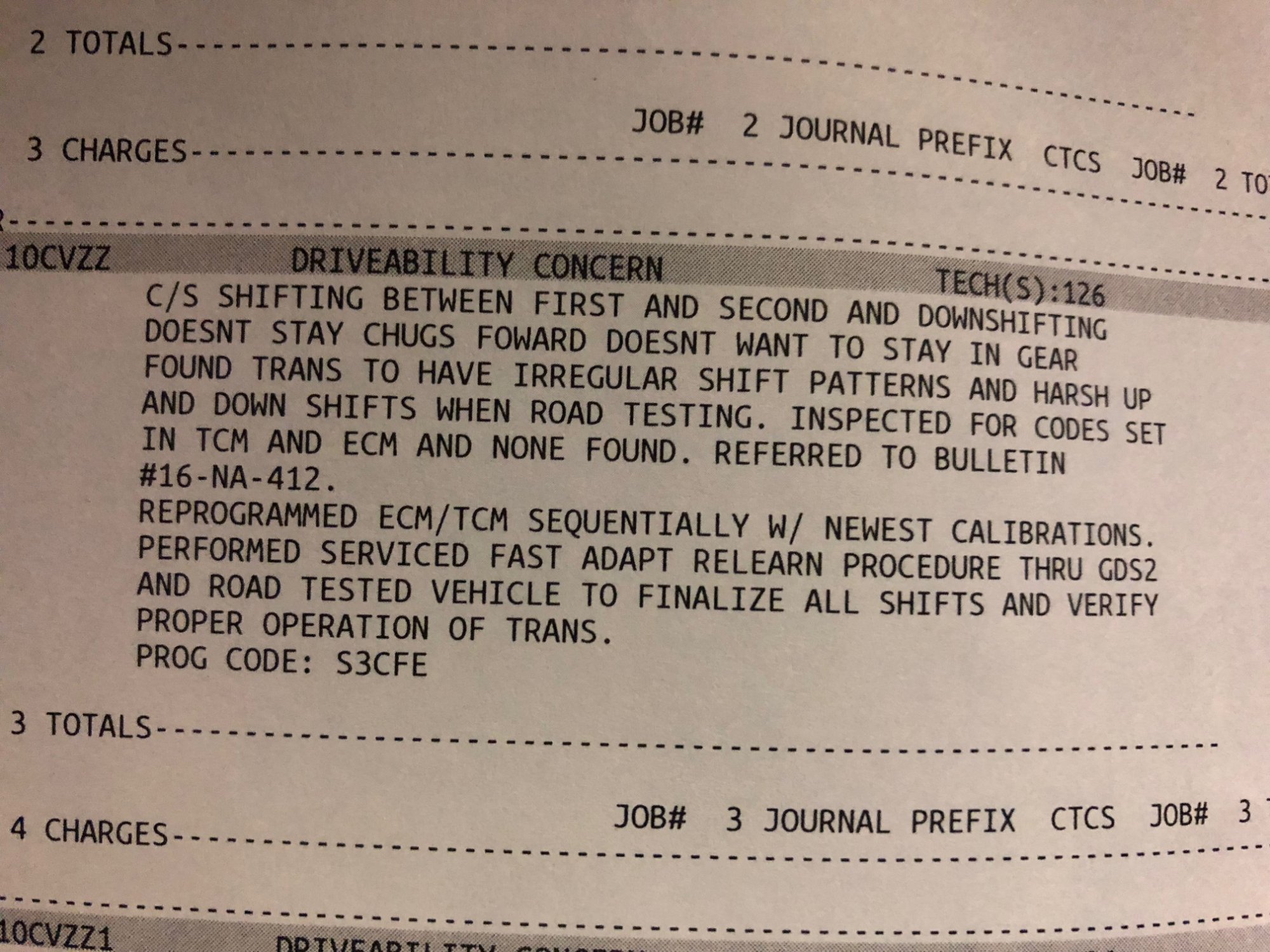

Hey Guys,
I have a 2017 with the 6.2L and 8 speed. I was occasionally experiencing moderately rough shifts from 1st into 2nd, especially when the truck was cold. When I would pull out of the driveway onto the street in the morning, it would sometimes slam into gear at around 8 MPH under light acceleration. The problem wasn't severe, just an annoyance. Anyway, I recently had it in for service (grease, oil, filter, tire rotation) and asked them to check if there was an update available for the transmission while it was there. When I picked it up, they informed that they did install a software update and advised me that it would be relearning for a while.
About half a mile from the dealership, I was stopped at an intersection and waiting for an opening in traffic. When I saw a chance to enter the intersection, I applied the accelerator and experienced hesitation. There was no response to the throttle for about 1 second. The truck then lurched forward and launched me into traffic. It only happened that one time so far, so not sure if it was a temporary problem from the reprogram, or an intermittant condition that might occur again. I haven't noticed the rough shift since the update, but it's too early to tell. I'd rather put up with the rough shift than the hesitation, as the hesitation could be dangerous. Reading through this discussion, it appears that others have had similar experiences.
I wouldn’t be too worried about it unless it becomes a reoccurring issue. I had my relearn done a couple months ago and the service advisor went out of his way to tell me “the truck will be learning your driving style over the next couple days. Don’t be alarmed as there could be times that the tranny will feel like it’s damn well going to fall out of the truck”
There was a couple random weird moments over the first two days and then everything settled in. The relearn completely cured my delay from park to drive on cold starts and my occasional jerky 2 to 1 shifts

I had to tell them "A buddy had this same issue and his dealer did this reprogram and it fixed it. Made a world of difference."  (Thanks to my "buddy" GM-Trucks.com) :D
They didn't bat an eye and did any optional update for the whole truck. They did note on the service invoice that they couldn't get what I was describing to happen but they still did the reprogram.

here's what they did for my 5.3 8sp... its a 2016... ..drives much better... .and gained 2mph per gallon!..
