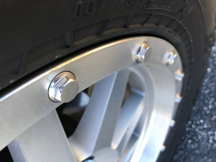

Pictures below of the rust.  Yes its small but its rust on a couple month old wheels. We spend big bucks on wheels in hopes they last.  These likely wont see a year.

These are the SS bolts and still rusting where the socket that was use to install them contacted the bolt head.

And the wheels have a matte clear but starting to see corrosion around the center caps so maybe when the caps were pushed trough they compromised the clear...

They are not SS bolts, they are more than likely cadmium plated.  Does a magnet attract to them?

Not anything new - these are known to corrode.  More so the nickel plated bolts on the faux rings, they sell replacements at $1 a bolt.  You can't get replacements off the shelf anywhere, they are super short and 'proprietary.'  I wish someone provided an aluminum direct replacement.  Still love my methods though!
I needed new hardware on my Method 301 bead locks and they actually sent me a set free...but those are much more pricey wheels and geared towards a specific target audience.  Run of the mill street locks, they would go broke replacing them all.
You can replace them with a real stainless bolt. I found a guy on a jeep forum that replaced his bolts. The thread is M8 x 1.25 in 8mm length.  https://www.mcmaster.com/#91287a147/=1bbvke0 25 bolts for $9. Might need a washer to go with them since they are a little longer then the ones that come with methods. I was going to do this with mine but I have since changed my mind and will paint them instead. I dont have issues with them rusting but cant stand the zinc yellow on the black rims...

I was going to suggest a REAL stainless bolt. There are many types of stainless that should not pass for "stainless" maybe stain proof lol. Just like I'll never order another 409 stainless exhaust :fume:
Yeah, stainless comes in a lot of flavors. Pretty much anything in the 400 series will rust much faster than something in the 300 series.
