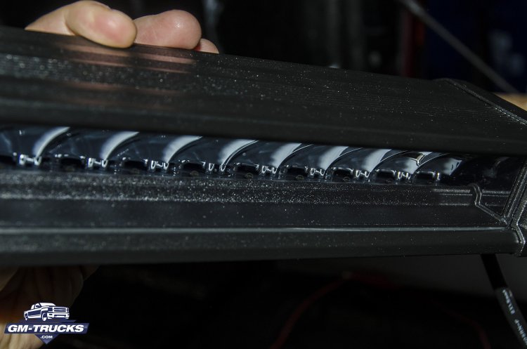

LED spot light bars are nothing new and as a result they’ve all sorta started to look the same. Now, that’s no longer the case.  With a futuristic parabolic reflector, the new line up of Sylvania LED light bars resemble the headlights on the new 2019 Silverado instead of the light bar from your friend’s old beat up Dodge Ram. With the LED chips mounted at a 90-degree angle from the road the curved reflector is the main focal point of the light bar instead of the LED chip or lens. It's a different, high-tech, motif that will look right at home on the 2019 Silverado and Sierra lineup.
However, all those good looks would be much less satisfying if this light bar didn't have the performance to match. And, since this light bar is made by Sylvania, it does. This 10-inch spot is designed to send light extremely far down-road. With only a 10-degree horizontal throw the 2300 lumen beam from the 10-LED chips is super concentrated. This spot bar will illuminate hundred of feet away but not right in front of you.  That makes it an extremely powerful, albeit niche lighting tool.

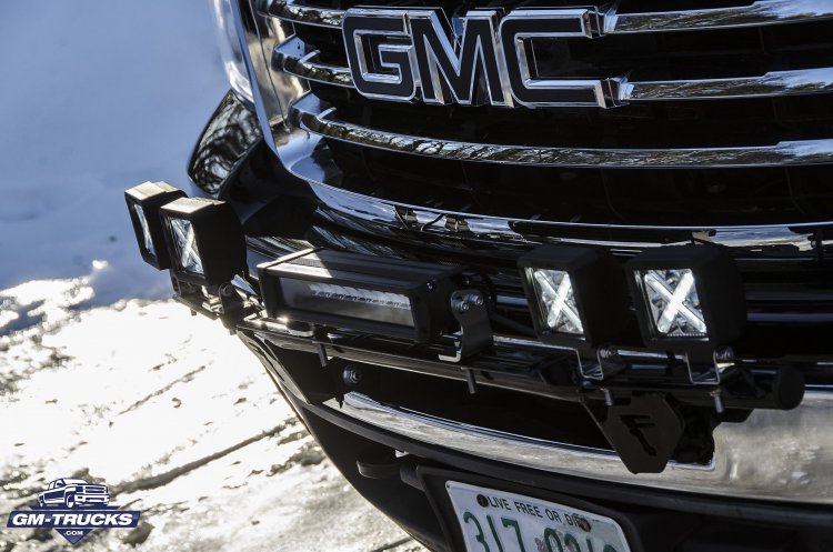

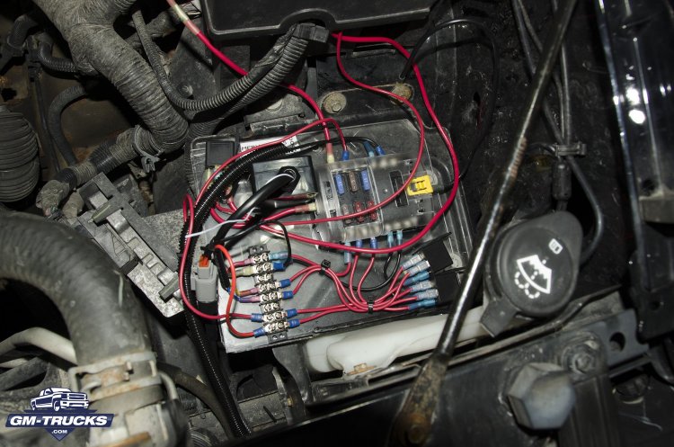

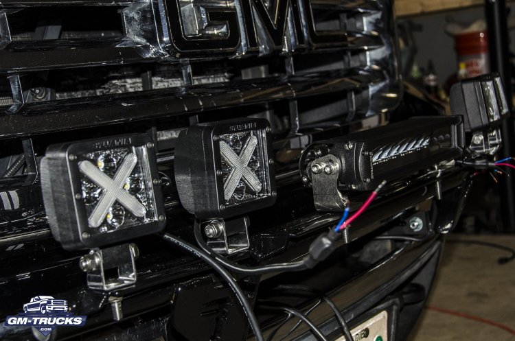

Above all, we wanted a simple, clean, and purposeful install for our LED spot lights. To accomplish that goal we mounted our five LED lights to an N-Fab light bar that was designed specifically for the 2011 Sierra (and Silverado) ahead of the front grille. To avoid complex switch wiring through the firewall, we ordered up a remote controlled two-channel 12-volt automotive relay and designed an auxiliary power center to control our new lights. Since these lights will pull some considerable wattage, we felt it was safest to create a power tap point that couldn't drain our battery and wouldn't interfere with our truck's sensitive electronics.
With this system our lights won't be able to turn on unless the truck is running and charging the battery. They also won't stay on after the truck is shut off. We also limit the DRL lights to only run when the truck is running. Although this system is very DIY, it's an effective and safe way add high power accessories without tapping fuses or wiring harnesses.  We'll have a write-up on how to create your own key-on aux power block in the near future. There's also pro versions of this type of aux power system you can buy.
Once we had the electrical wires run through flexible conduit (purchased separately) and the mounting hardware tight, we cleaned up the install with wire ties. Some of our Cube-X lights had shorter wire harnesses than others, making a clean look harder than we wanted. You can see on the photo below how we would have preferred the Cube-X wires be longer, so the connections could be hid farther behind the grille.

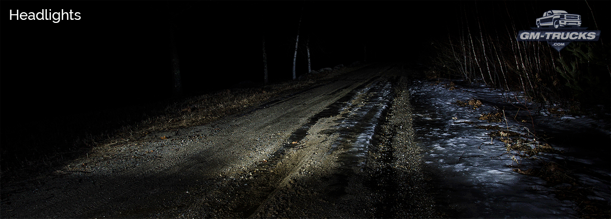

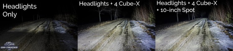

Safe to say we were right. Take a look at these comparison photos.
As you can see, the four Cube-X lights gave us the most improvement for the largest area. That's no surprise, as the lights are all together "worth" 4,680 raw lumens. The 10-inch spot light excelled in throwing a direct and bright beam farther than the Cube-X lights could but is only rated at 2300 raw lumens. That concentrated beam illuminated deeper and farther ahead than the Cube-X spots. Take a look at this animation to see what we mean.
The next day at our garage, we took a more measured approach to comparing brightness using a light meter. We measured the output of our headlights and the spot lights inside a dark room with no outside light to compare them. The results are interesting. With all five LED lights firing, our Sylvania spotlight setup is 14.5 times brighter than our aftermarket LED low-beam headlights alone. All five lights are 4.7 times brighter than just using high-beams. The Cube-X array is 4 times brighter than the low beams. All in all, no matter which way you measure, it's a massive upgrade in light output.
