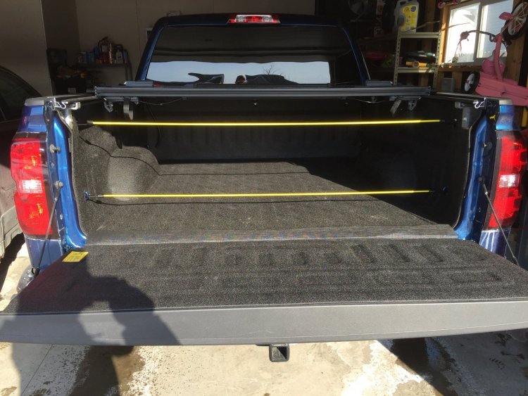

I’m looking for a net that would hook like I have these bungees poctured. I would be for  holding in groceries, so I don’t need a heavy duty divider.

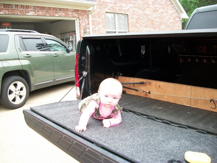

A 2x8 or 2x10 cut to the width of the bed should work, and is cheap.  Easy to remove if you have to haul big stuff.

I just have a 2x4 and it works great. Sure beats having to crawl up to the front to grab the milk jugs when they slide up to the front of the bed. I would think a board would be easier and faster to remove than having to attach the 4 hooks. plus it sits tight to the floor so small items can't slide underneath like a net would allow.

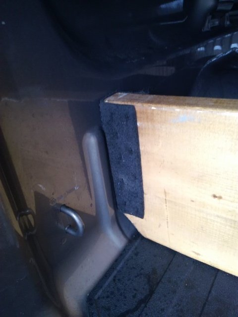

I used a 2x10 which fits between the bed ribs forward of the tiedown loop. Looks like your liner molded these ribs. Cut for a snug fit. There are other mounting spots(ribs) in the bed.

I do this. ^^  (Also yellow!)  I use plastic buckets for my groceries and have a rubber floorliner.  Cargo doesn't slide.   A couple of added vertical bungees or X the horizontal two are options.
