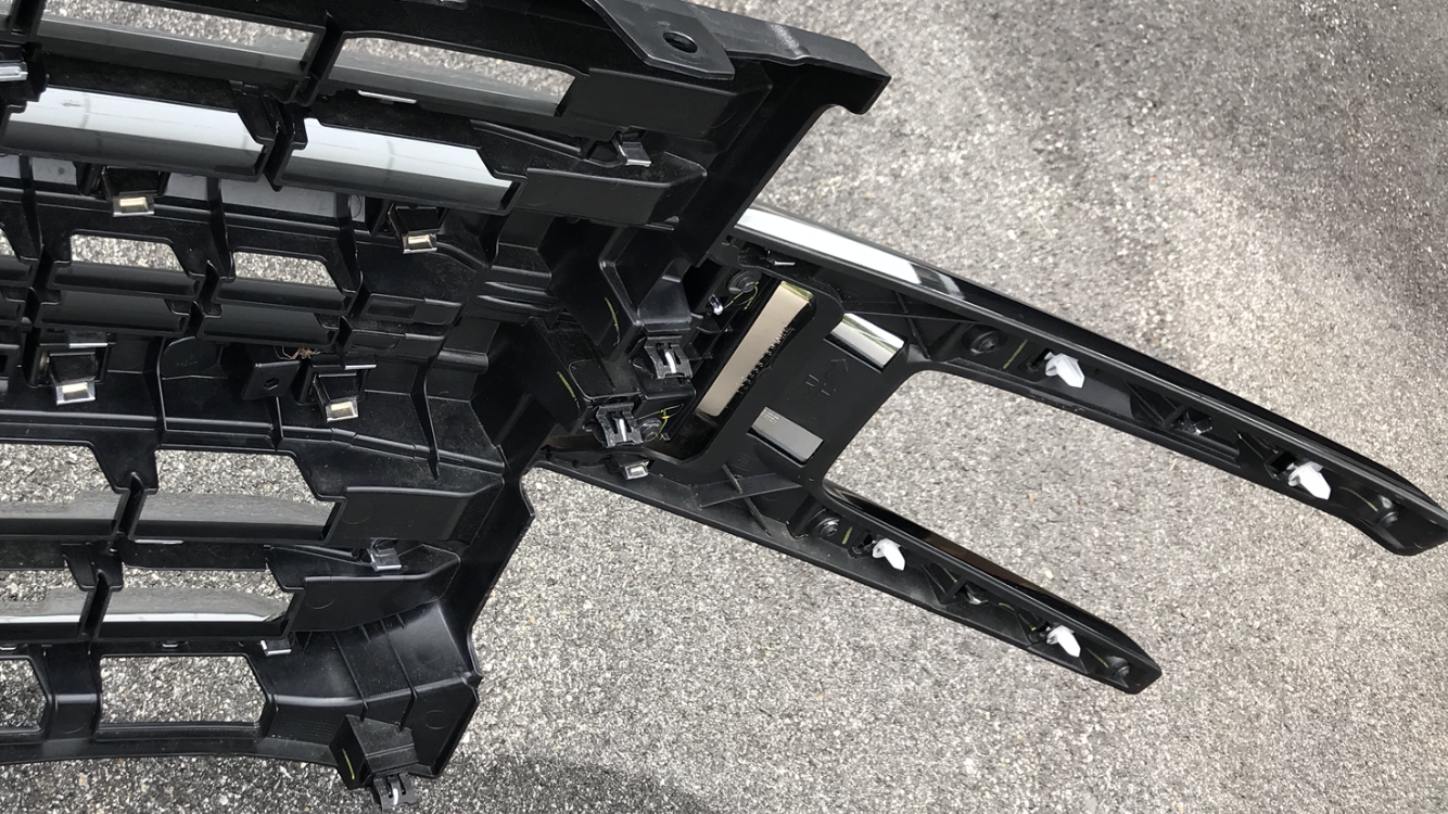

On 9/2/2019 at 4:03 PM, SatinSilvy said:
Took off the chrome grill and installed a black one. FYI if you purchase the black OEM grill from Chevy it comes with the black bow tie. The parts guy at Chevy didn’t even realize that. So that saves you $80 bucks right there.
For Sale: Chrome stock grill :)
I'm thinking about getting one. Can you post some other pictures, and was it easy to install.
The dealer printed out an exploded view with some stuff on it that I couldn’t even read/make out so I just had to go about it on my own.
Take out all the push pin clips, remove the tray looking thing. It will open up and you’ll see 4(?) bolts I think they were 10mm bolts. Take those out and then literally pull the grill straight out. Everything is held in with clips.
