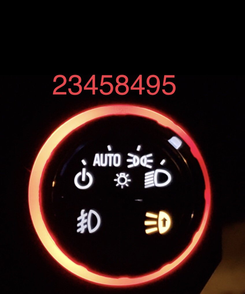

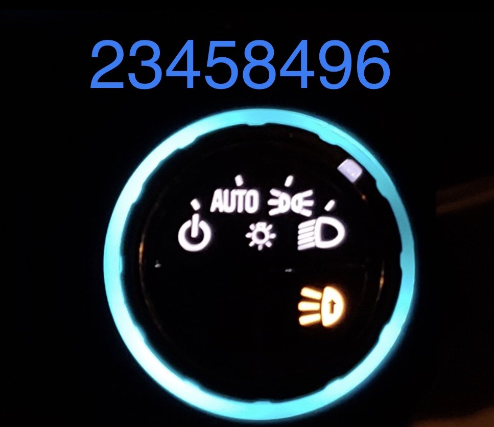

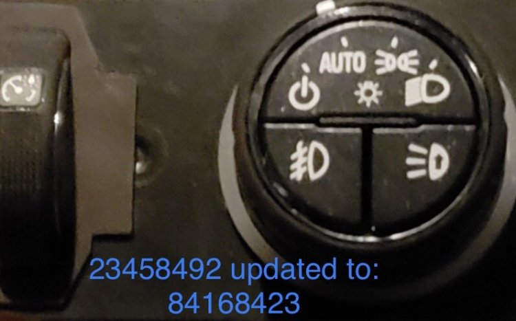

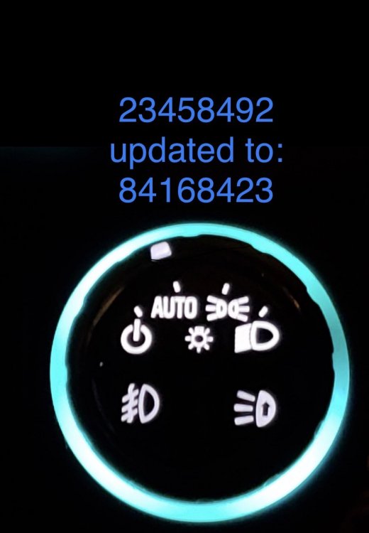

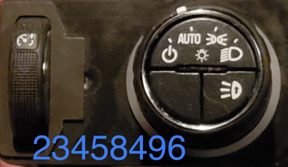

I am looking to buy the blue version, but I am seeing on multiple websites that the 23458492 and 84168423 has been replaced by 84448506.  Although I don't see anyone else on here struggling with this, I just wanted to make sure that the part number was actually replaced or if these sketchy GM Parts etc websites are putting out false information.
Not sure if you bought it already, but yes, the new one(blue color) is the 84448506. I bought mine off RockAuto, cheaper than what I saw on eBay and other gm parts store(online).

ACDELCO 84448506 Headlamp Switch
$ 138.79
I have kicked around the idea of doing this as well so searched the part #. Many online places show it as not available or discontinued. You're right on eBay as it shows it north of $200. RockAuto shows it as an option so they must have access to some. Maybe I will order up one just to have it on hand. Thanks!

Welcome! Yeah, they are either over $200 or they are out of stock. Just got lucky my search showed RockAuto and it was cheaper than the rest.
I paid something like $30-40$ for a blue back lit one. And $130 for the f#$%^ red one. Seriously considered switching the back lighting to blue in the 2014 before buying that switch.
