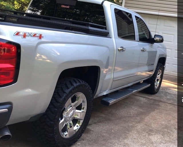

Do you think the zone 4.5 would look good with 33's? I see so many folks running 35's with these kits but my tires are fairly new and I dont want to get rid of them.
Zone 4.5 on 33s
2017 Chevy Silverado LTZ Z71 6.2L
4.5" Zone w/ Bilstein and Fox
22x10 American Force Grips
33x12.5 Nitto Ridge Grapplers
Instagram @wildchevys
Dang that looks good. I am running the stock 20inch LTZ wheels. Would I need wheel spacers with the zone kit?
I believe people have done it with your UCAs, but it really depends on the tires. I have stamped and I clear barely with 275/60/20s.
Zone 4.5, bilstein 5100 front stock height, fox 2.0 rear.
The narrow 33s look a little on the small side, but not bad. I'm in the same boat, only 10k on the tires. Will be putting 34's or 35's on when they wear out, but they look fine for now.
