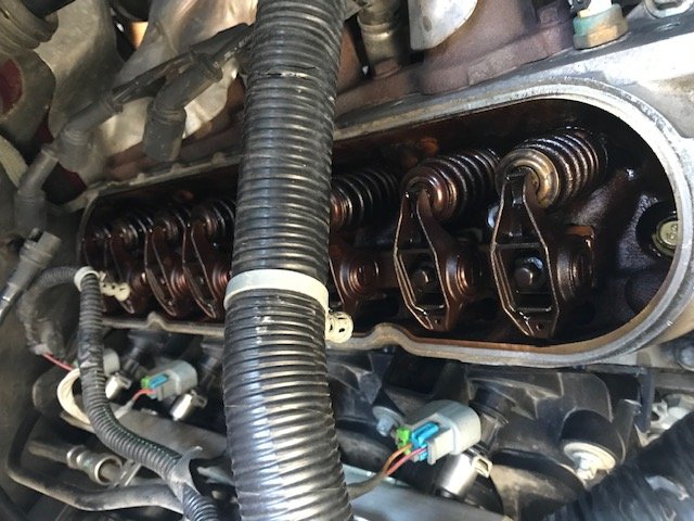

OLM always seems to be a hotly debated subject. I have a 2009 6.0 with just a tad over 200k that I recently bought. I pulled the drivers side valve cover to swap it to the new design. By the service records the previous owner was very diligent to run full synthetic oil and ALSO run the OLM all the way down before oil change. Some oil change intervals were over 10k miles. This 6.0 is running well with great oil pressure and very little lifter noise HOWEVER if you follow the OLM then what you see in the pics below will be inside YOUR engine too. The deposits are not baked on and wipe off easily with a paper towel but obviously the entire engine is coated with this layer of sludge. Probably does not hurt anything? If that does not bother you then go ahead and run the long oil change intervals. Too late for this 6.0 but I will never run one past 5k miles before an oil change. Oil may test just fine at 5 maybe up to 20k or more miles but if it leaves sludge chit hanging around my engine then to me it is not worth saving a few bucks and it my oil gets changed well before the OLM indicates it is due.

Incorrect... as I said earlier I have over 200000 miles of doing 20k changes and it does not look like that lol.  The aluminum on the heads is just clean cast. Can't just make blanket statements especially if your history and proof is a truck you just bought and isn't what you put in the truck yourself.
