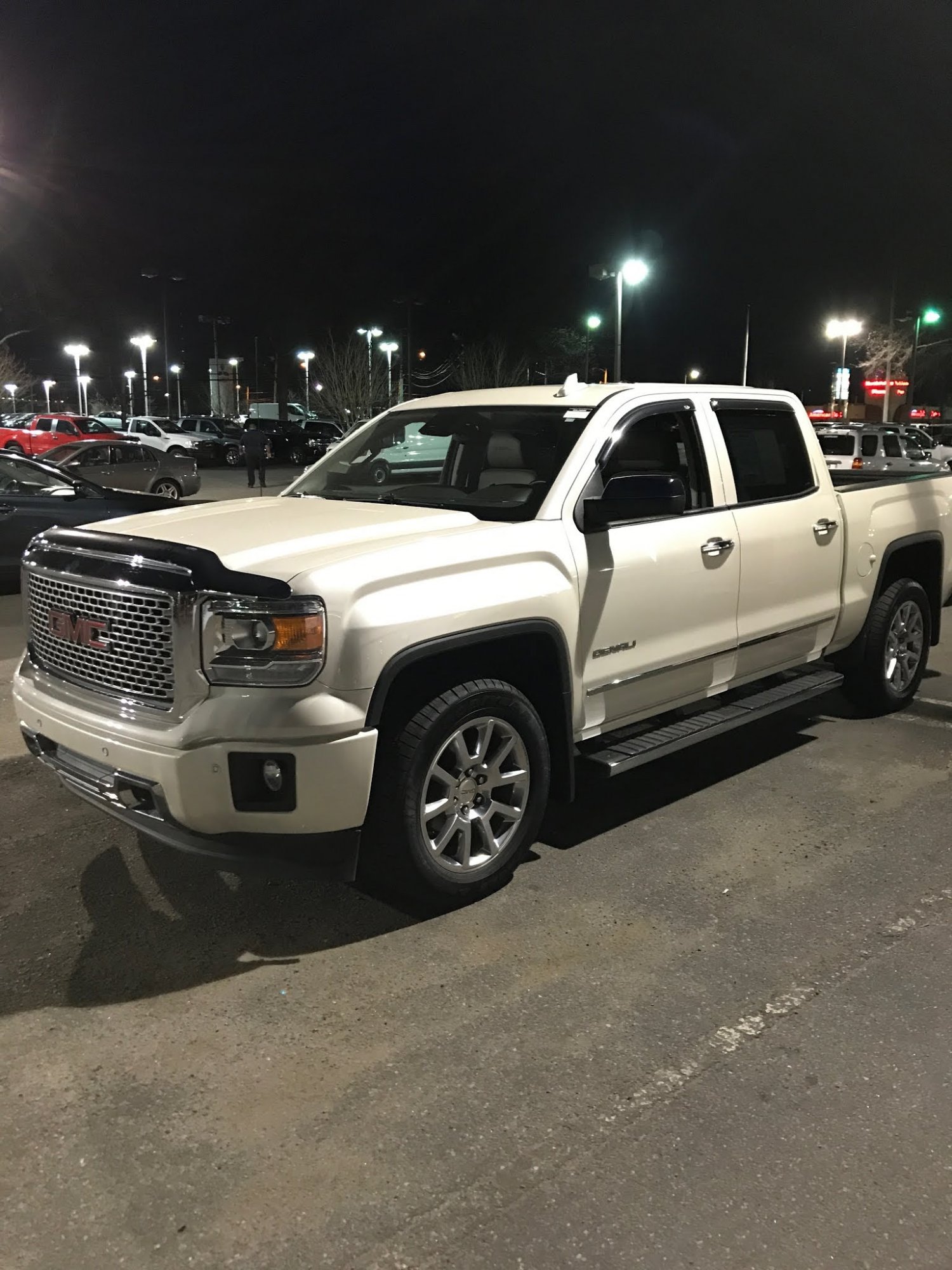

Hey guys, new here, but could really use some help with my 2015 GMC 1500 Sierra Denali. About 2 months ago, my truck started making this squeaky/clunky noise. Took it into the GMC dealership and they said both front shock assemblies needed replacing. Well, as you all know, those shocks are like $700/piece and the total bill was like $1900 for two front shocks. Crazy!
I would like to put a leveling kit on the truck with some more aggressive AT 33's, so I figured I'd have all this done at the same time. Should I replace all four shocks, or just the front two? Can anyone recommend some shock assemblies that won't completely break the bank but that will give me a good ride? I've had several friends go with Fox. Also, if anyone can recommend a good shop in Charlotte, NC to get the work done I'd really appreciate it!
Thanks in advance!
