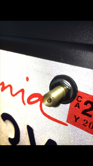

  1. I have the Airlift plumbed separately, but I really don't think I matters. I used the license plate holes to run my lines to.  Kinda off subject, anyone hear a clunk when jumping up and down or pulling into a driveway or going over a speed bump?  I just cant see anything else it could be than the bags. Leafs have pads and shocks are not loose.?? thanks!
