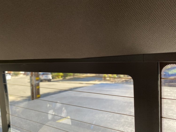

So I dropped off my 2020 TB LT on Thursday to have the leaking rear window fixed. I was called and told the truck is ready this AM.  The dealership told me it was the 3rd brake light leaking, and not the window.  So after signing the paperwork I said "I'm going to go inspect my truck real quick".  I looked at the 3rd brake light from the bed of the truck and all looked good.  Then I went in the truck to look at the rear window area and I saw "blue fiberglass" dust all over my leather seats.  Then I look at the headliner and there is a noticeable 4 inch crack in the fiberglass liner and the fabric is buckled where the crack is.
I go inside and ask for a manager, who comes out and he immediately sees it.  He said they will fix it, but wanted me to know how involved the R&R of the headliner is.  My truck is black so I feel like the paint is so soft that if you sneeze on it, it will scratch.  I don't have faith they can remove the windshield and install the headliner without doing some type of damage.

2 hours ago, lebag335 said:
Picture of headliner showing the dip??
Here you go. Not very visible but when (lightly) pressed with a finger it goes all the way in.
  • Thanks 1
Thanks for the tip to let them know right away. I actually took it back just now so that service advisor could see it for himself and make a note for next time. He had the tech look at it and apparently the headliner fix is a bit more involved where they have to take the pillar covers back off and glue back to the roof *sigh*. Nothing surprises me anymore..
Forgot to mention, I asked my service advisor what their process was (just to make sure he was familiar with this issue) and he rattled off everything in the TSB without looking at it and said "you wouldn't believe how many of these we have had to fix".
There is a slight dip in mine after they sealed the read window but it is not as bad as this.  Mine doesn't dip below the metal frame/bar.
