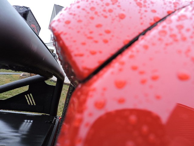

On 2/4/2020 at 9:28 PM, econometrics said:
Yeah, the automatic car wash theory is a red herring.
It's not the "automatic car wash theory", it is the "only cause ain't necessarily the window frame or window frame sealant theory" and sealing the frame alone may or may not solve the problem.
Even assuming the frame is not cracked and/or sealed 100% it addresses only part of the potential leakage problem. There is a thin, very thin, pressure fit gasket without sealant sandwiched between the metal body and the polymer spoiler. Spoiler is attached with screws and clip retainers that fit into holes in the metal roof that extend into the interior directly above the headliner. Leakage at any one of these holes drips onto the headliner which loosely rests upon the inside of the window frame causing the water to drip along the inside of the window onto the seats and floor. And, this will occur even if the rear window frame is cracked or not or even 100% sealed to the body.
So the best guess is this....and take it for what it is worth.....if the leak is due to a cracked or poorly sealed window frame then replacement of the frame will work, but if the leak is caused by leakage past the pressure fit gasket , that will not help and water entry will be through either a screw or clip hole in the metal roof. Been there, done that with the trunk leakage on my Camaro, dealer was constantly playing around with the lip seal while I found that leakage was past the gasket and through one of the screw holes through the trunk lid.....another time through a screw hole past a roof rack seal. Exhaust gases or coolant can find its way through a defective head gasket....the spoiler and roof are milled nowhere near the tolerances of a block or head, so likely water under pressure , or could just through a poorly fit gasket, can find its way through a hole in the roof into the interior.
Hand washing may not help if the gasket is defective, but certainly reduces the risk of entry under the spoiler seal.  Photos show the fine fit and finish of the body against the ultra thin gasket and at least a portion of mine will permit a piece of paper to get partially past the gasket seal......nopt forcing it becuase I don't wnat to create a leak........think a blast of 300 mph air could force water past that gasketDSCN0795.JPG.744f4e70aaf0aa9384e696ac89af6de9.JPGDSCN0800.JPG.618e0328eb0ae867880b3f026fa36dc0.JPGDSCN0798.JPG.c9802c10e0eea73a26213cdd932fa13d.JPGDSCN0797.JPG.5467836372b92ca0f34d490f745eb6ab.JPG?
For my .02 if it was me doing the repair each clip retainer or screw hole though the metal roof securing the spoiler would get a big glop of silicone rubber before replacing and anchoring to the body. This way if water gets past the spoiler gasket, it will not drip onto the headliner and compromise the interior.....and if necessary the spoiler could still be removed with a little bity of effort if necessary in the future.
