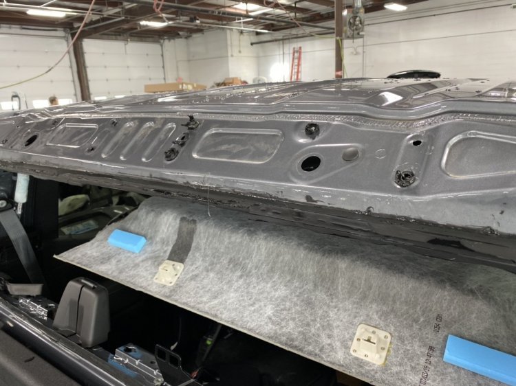

44 minutes ago, SilveradoRST said:
Anyone know how many screws hold the rear spoiler to the top of the cab?  Is it 2 only?
Many more than 2. There’s a pic of a member’s truck with the spoiler off a few pages back in this thread.
I saw those pictures.  I see there were a few plastic retainers on the inside of the spoiler that snaps into the cab.  The TSB for the rear window leak sealant process looks like there’s only 2 screw around the third brake light once you drop the headliner. I know the picture may not tell the whole story.
Reason I ask is I had the sealant done recently and I found one single 1 1/2” or so black bolt/screw (sorry not good with the terminology) on the backseat.  I’m guessing the tech didn’t put it back where it belongs.  I’d rather not go back to the dealership if it is not an immediate issue I need to address. But if my spoiler is only being held by 1 bolt and a few plastic retainers then I guess I need it addressed.
