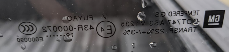

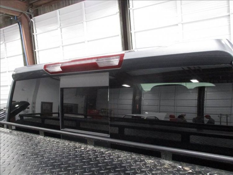

New window installed Jan 31st no leaks. Replacement model was FUYAO 43R - 000072. The exact same one that was in it to begin with. So, we'll have to see if this is a bogus window as well.
As for the trash headliner and interior dome light, dealer and CS supervisor are saying they're on national backorder at the moment but the parts are in queue.
What a helluva car buying experience! They should just market that every Silverado with a rear sliding glass comes stock with a koi pond!
This was my stock/original window from 2018:
This is the new window put in this week:
I'm not sure what all the numbers mean, but seeing quite a few number changes.
Looks like we received the same model man.
Also, I'm from GA too brotha! #GODAWGS
The first section, “43R”, indicates the part conforms to  European standard of safety regulation number 43. The set of numbers that follows, “000072, is the approval number assigned to the part.
So my assumption is this is a new batch of windows -- I may be mistaken though.

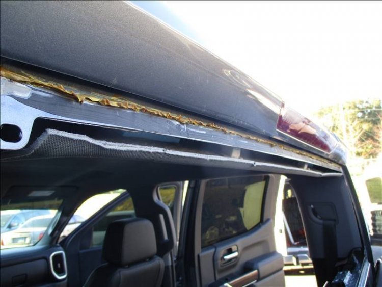

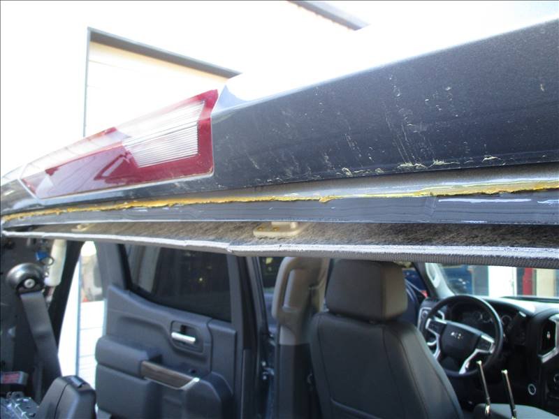

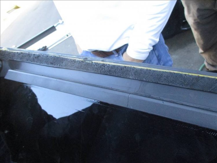

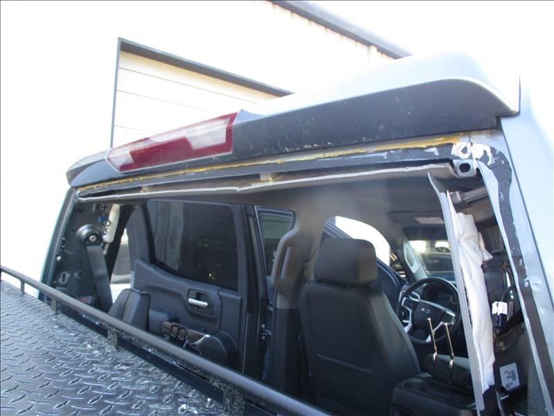

For record keeping, the body shop says the issues they found were the cracks in the upper rear pillars and cracks within the plastic assembly.
Here's photos of the repair process.

Is it fair to say it is the less than stellar plastic used by the rear window manufacturer that's cracking and thus causing the leaks?  I saw the picture posted here earlier of the cab design where it slops down behind the spoiler and onto the top fo the rear window frame.  I know some say it is a bad cab design.  And I get GM has say in the quality of the plastic being used on the frame, so GM is accountable.  Just asking the question to better understand the physical fault point.
