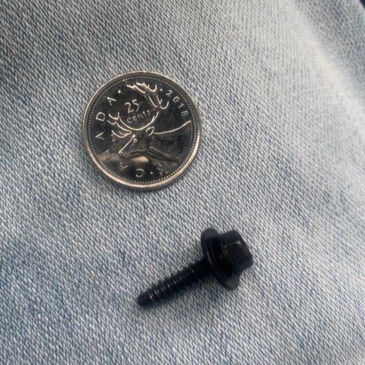

Just wanted to follow up on my bolt left behind after my window sealant work.  Seems like it wasn't an 1 1/2", but the length of a Canadian quarter.  Similar size to a US quarter.  I'm hoping it is a bolt that belongs to anywhere but the ones holding up the spoiler from inside/underneath the headliner.  If any of you guys have any idea, please let me know.

Forget about a hairline crack in the window frame.......the crack was SOP for the removable Avalanche rear window where the glass expanded from heat faster than the plastic frame surround and cracks developed in the frame.........but they never leaked water. It's all those holes punched in the roof metal directly above the headliner area that scares the crap out of me. I've seen this before on Camaro trunk mounted spoilers, Chrysler trunk mounted luggage racks and outer fender wells where gasketed screws are used to prevent leakage. Once removed they need new gasketed screws. That's why absent leakage my spoiler can pop all wants in the hot Sun.....no way I'm taking it in for a dealer removal and reinstall.
Currently mine is dry as bone after 4K miles and 6+ months of hand carwashes,  mountain thunderstorms, high speed runs in the rain, and 2 days of 6 in. of melting snow on the roof. My .02 experience with the Salio snot used on the seals of my Avalanche submarine was to keep it away from any hands free carwash that blasts a narrow stream of 300 mph air across the roof and blows out the crap spoiler gasket and sealant (if any) in the holes into the interior...I won't even spray a hose directly into the narrow gasket area separating the spoiler from the Silverado body let alone blasting with a pressure washer or forced in by 300 mph air......and once these seals are compromised they continue to leak.
And the dealer can goop up or replace the frame or spoiler gasket as directed in a TSB, but unless the seals for all entry holes to the roof are addressed it may still continue to leak or blow out the next time it is compromised under pressure.
