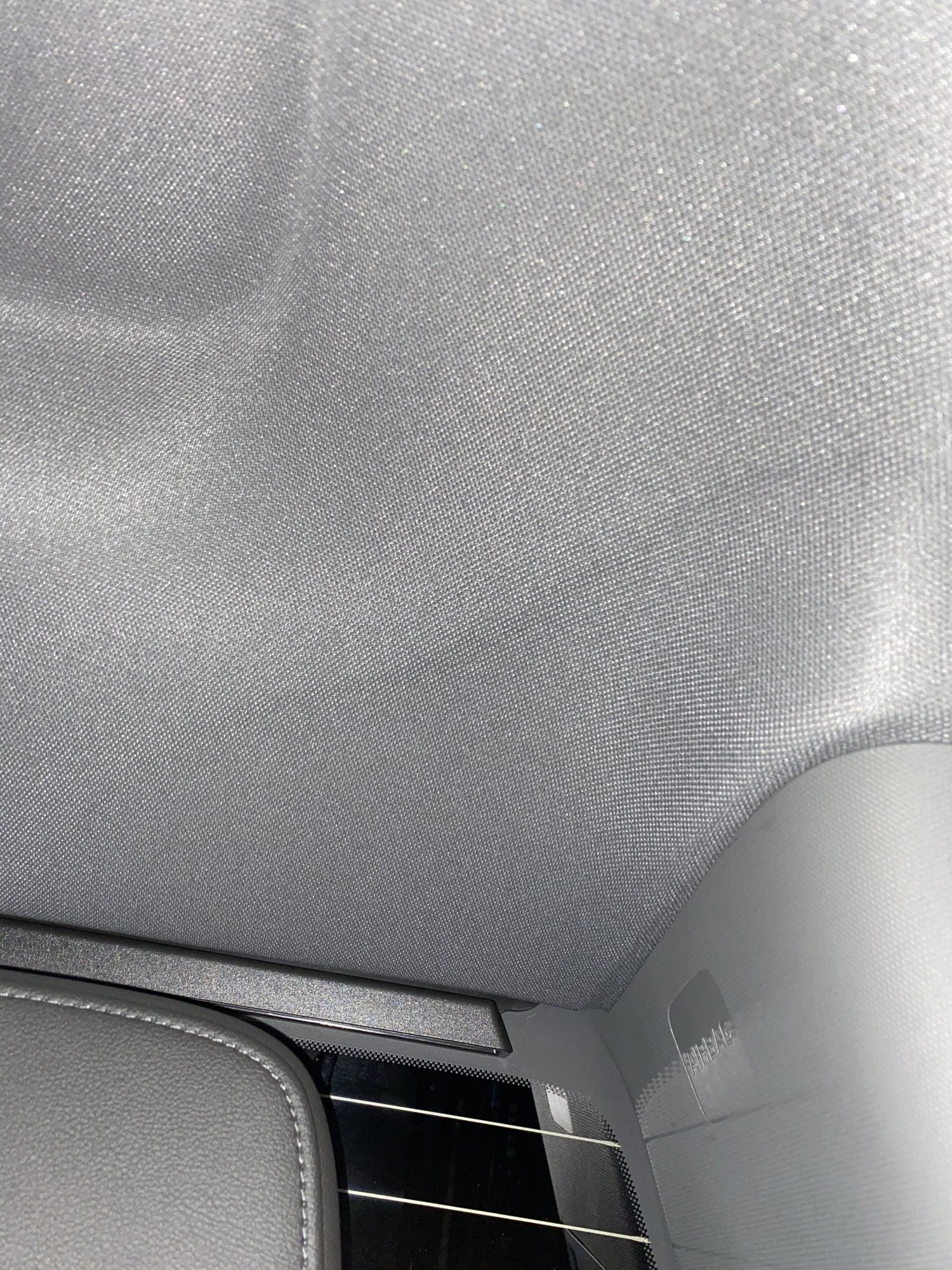

For record keeping, the body shop says the issues they found were the cracks in the upper rear pillars and cracks within the plastic assembly.
Here's photos of the repair process.
Did they take your window out without removing the spoiler?
and that caked on yellow stuff looks like the original repair wasn’t done like the TSB requires....
doesnt look anything like other repairs on here

Yeah the rear window assembly is removed by removing the back seats to disconnect the electronics and then they can cut your window out with basically string. The glass guys will clean up the old caulk etc and just install it. It turned out better than factory. The spoiler doesn't need to come off for that purpose but they will remove the spoiler during the initial TSB caulk job.
As for the yellow stuff aka the caulk, it was applied as the TSB says to do so just in a crappy fashion. You have to remember dealer's and service techs don't really care about warranty stuff like this and are gonna half ass things.
I had GM forward the window and the bill to a third-party collision body shop for all my repairs moving forward. So, they did a bang up job on the window swap.

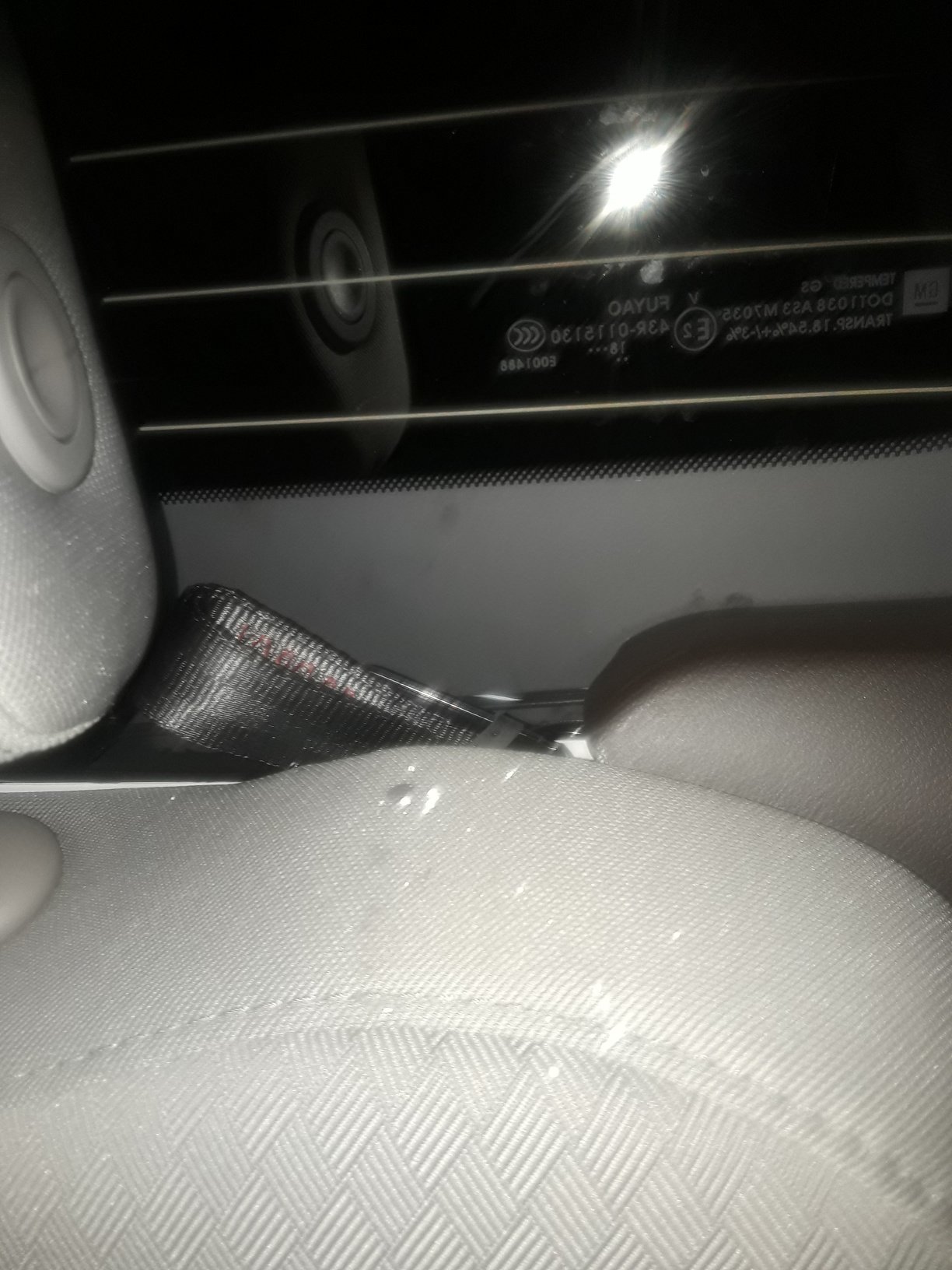

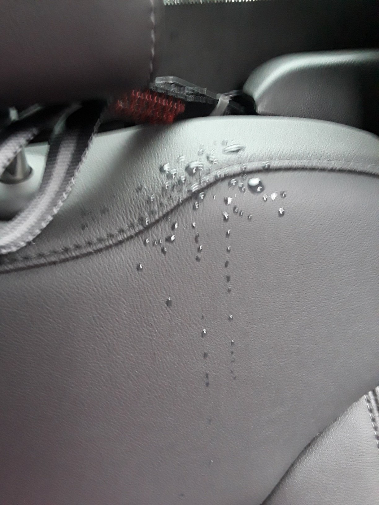

I had purchased mine in March and only been driving to work (4.5 miles each way) so I didn't ever see, November 11th we went to the In-laws and it was raining, My 10 year old says I'm getting wet, It was scheduled for its first oil change on the 26th, said they would need to keep it for about a week, I told them I would need a loaner can't be without wheels for a week, so I had to wait almost 1 month, they called, I dropped mine off and pick up a 2019 Z71, last night we are coming back again from my in-laws, we stop to get gas and my 4 year old daughter Mom! this truck leaks in the same place as daddy's truck!
My Silverado
Their Loaner Z71
Well took them 21 days working on my, Thinking I've had it back for 2 weeks now, Initially I got it on a Thursday had to take it back on Monday seems they did the brake recall and broke it, they only kept it a day on that. So far no leaking.
I had brought my 2019 silverado in for the rear window leak and they repaired it using the service bulletin. I went in to go pick it up after the repair and told them i wasnt accepting it because their worksmanship for the repair, and also they did not clean up the rust that had built up on the bottom seat bracket. They called me back after the weekend and said it was g2g so i went to pick it up. There was still seam sealer left on the window and its visible between the glass and body. Minor issue because you wouldnt notice it if you werent looking. It looks like they tried to remove the rust with a wire brush and sand paper. They actually took off the paint in some spots down to bare medal. And i also noticed a white mark on the plastic trim on top of the sliding glass. Looks like some seam sealer made it onto the plastic and they used a harsh chemical to try and remove it. So after fighting with the dealership and GM i am scheduled to return the truck Monday to have a GM representative to take a look at it. Why does this process have to be such a PAIN. The dealership said i have to get with GM to figure out the next steps, and GM said that the dealership should be handling. No one knows their asses from a hat and as soon as they have your money it seems like they do not care whatsoever. What exactly is the GM rep going to do? Why does a gm rep have to look at it after it was the dealers fault their technicians are incompetent? I have had less problems with my 90s japanese shitbox. Very frustrating experience. Especially this being my very first new vehicle purchase.
