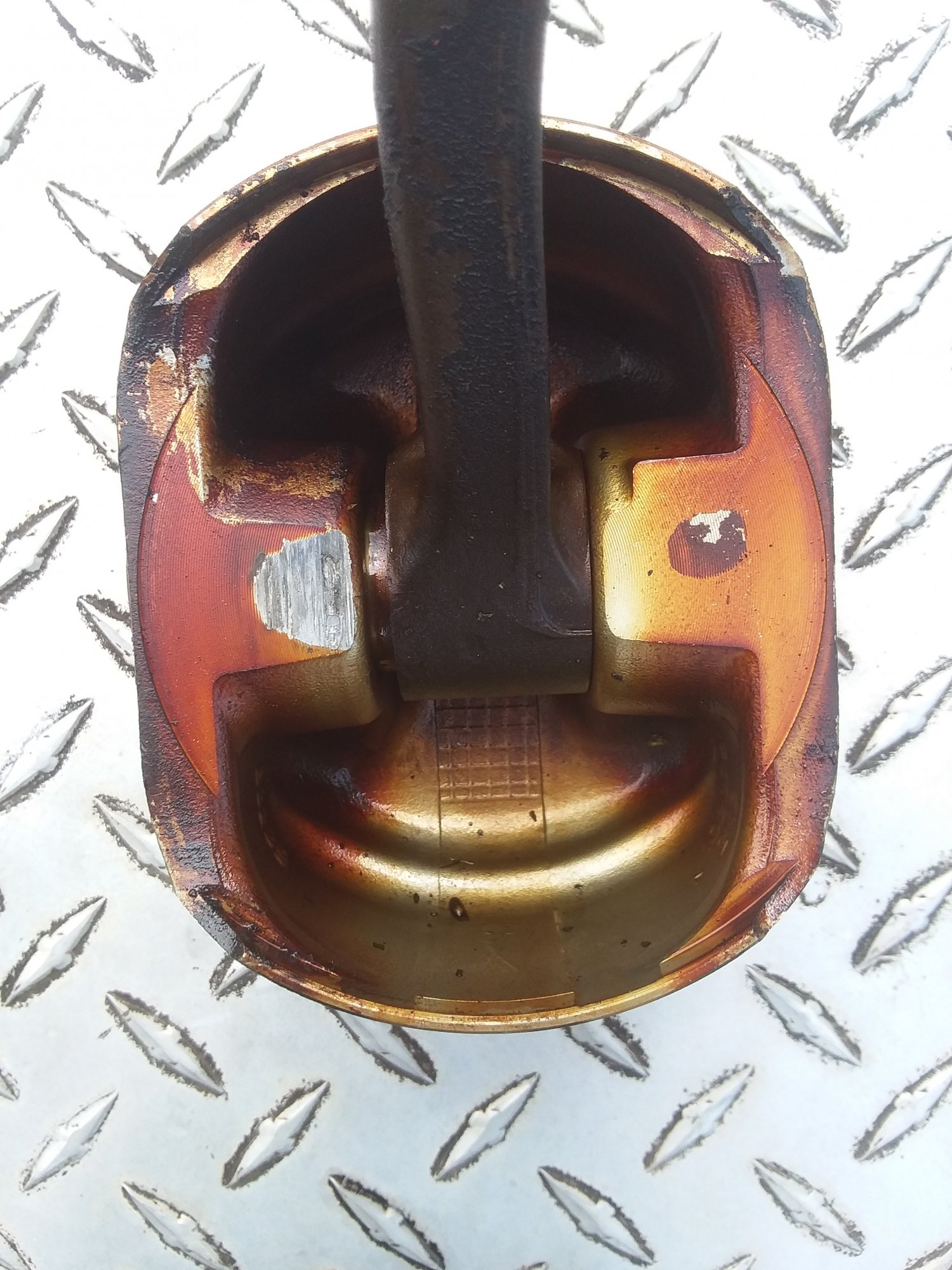

Sorry ant had much time to work on the truck. The new motor I purchased with 115000 on it is bad also want hold oil pressure over 20 psi even with two new oil pumps and a manual gauge. So its going have to come out. I started tearing old motor down yesterday. Staring taking rods loose and when got to six it free up. I could turn the crank. All rod bearings full oil and main bearings looked good to. Found that the number six piston is hitting the counter weight on crankshaft, which is causing it not to turn. Don't see how could happened or what is causing it. Only seen this in builds but never a motor with180,000 on it.
Some weird luck and a crazy random issue caused the rod to bend like that.
Lol I would agree with that, some luck I am having with this truck. So you think rod some how bent? Waiting on a new one to compare it to. But something some how only made one rod short enough to hit counter weight on crankshaft.
