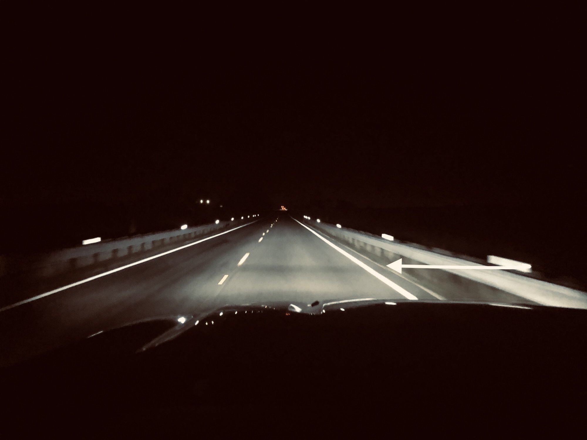

I have a 19’ LTZ and also thought the lights were aimed high. I have attached a picture that shows a void line in the line of sight with the high beams on. The void line is still visible on low beams without the fog lights on. Everything on the truck is factory.
I had the dealer look at my headlight adjustment and they said they were adjusted perfectly. I told the service manger I was not happy with the dark void in my headlights, so he submitted a case with Chevy. He got back with me to tell me Chevy is aware of the problem and they have no fix as of yet. He seemed to think the dark void line that I’m seeing is from how the headlights are designed.
My initial thought was the lights may be aimed to high and adjusting the lights lower may get rid of the dark void line I’m seeing.
Has as anyone else noticed a dark void line in the headlight output?

Yes. 2019 Sierra. My dealer just dismissed my complaint and said it was adjusted correctly. My other complaint is the back up lights.  Ina dark environment it’s was very difficult to see so I  added aftermarket LED lights under rear bumper tied to back up lights. Great improvement.
