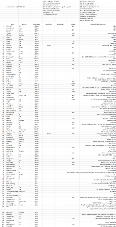

Here is a spreadsheet of mostly everyone from this forum [plus some from Facebook] and I tried to capture everything someone said about their experience. Just click on the pic and use the Magnifier to expand to read.
That is great work. Over 100 people on forums and FB having brake failure. Scary since this represents only a small fraction of the overall owners.
