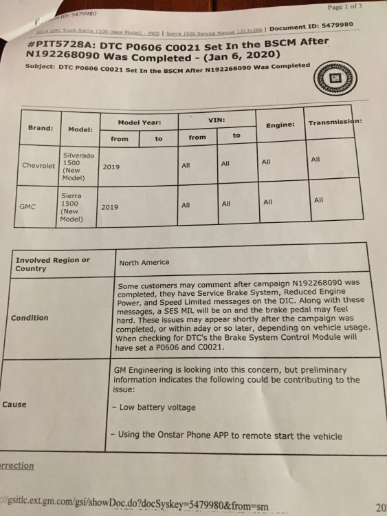

Jeff and his Silverado Posted January 13, 2020 Posted January 13, 2020 count me in on the class action law suit. I should say if you're one of us having the brake failures, DON'T USE THE GM APP TO START YOUR TRUCK. use the key FOB or just go start it yourself. I was told by my dealership that the app is messing things up.

rmkmb Posted January 13, 2020 Posted January 13, 2020 Same thing happened to me after the recall was done,and I started the truck with the app. there is a bulletin issued on January 6th and GM confirmed to my dealer that it is in fact a bug with the app that the brake issue is cause by starting the truck with the app. On my service ticket it says not to use the app. Hope this help.
