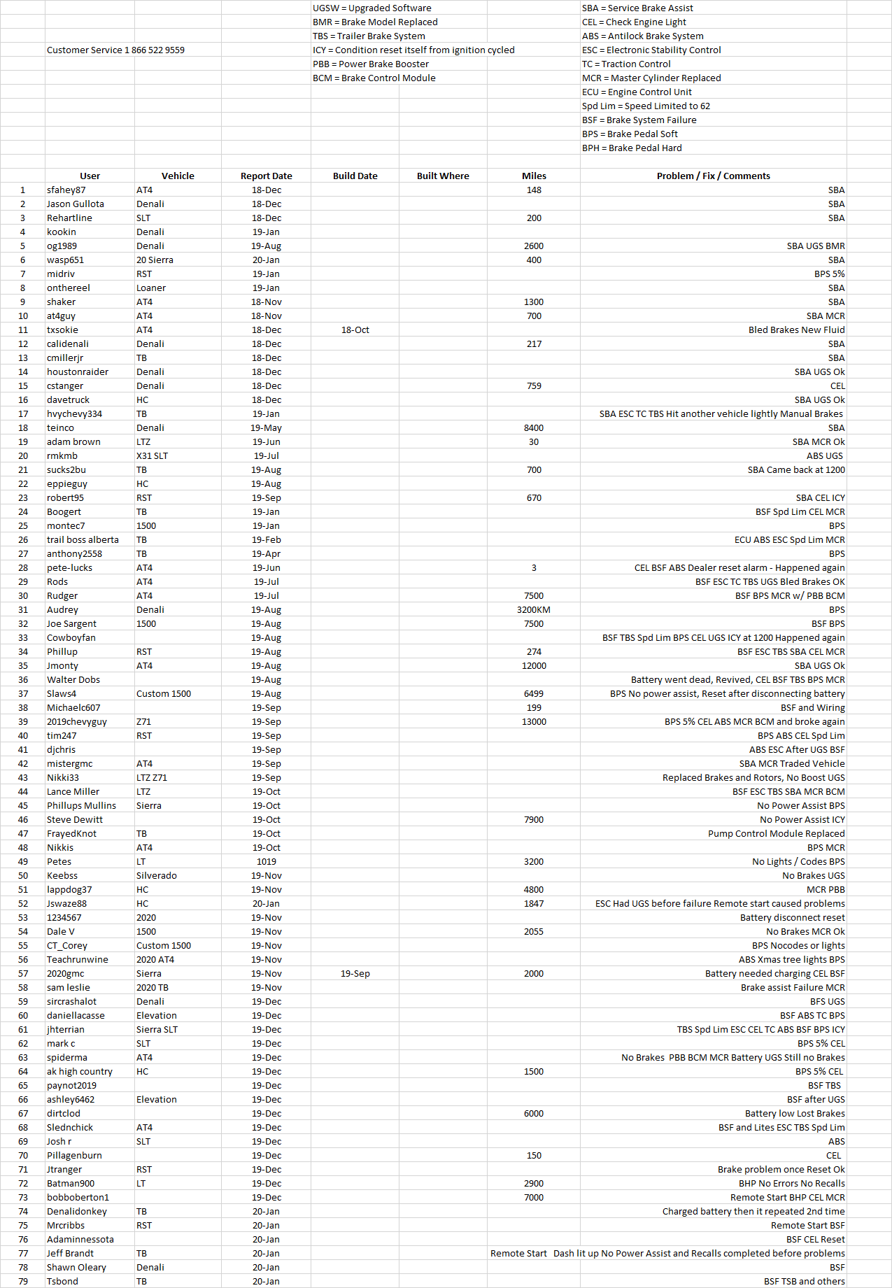

The above list is everyone in this thread and a few others with problems with their brakes. Click on the image and then enlarge.
That’s impressive, yet scary. And to think how many others that own these trucks are experiencing issues, but aren’t on this site.
Yeah the Silverado / Sierra Facebook Group is filled with users with this problem. I am sure there are repeat entries but there is still alot and they cover almost every event of brake loss.
