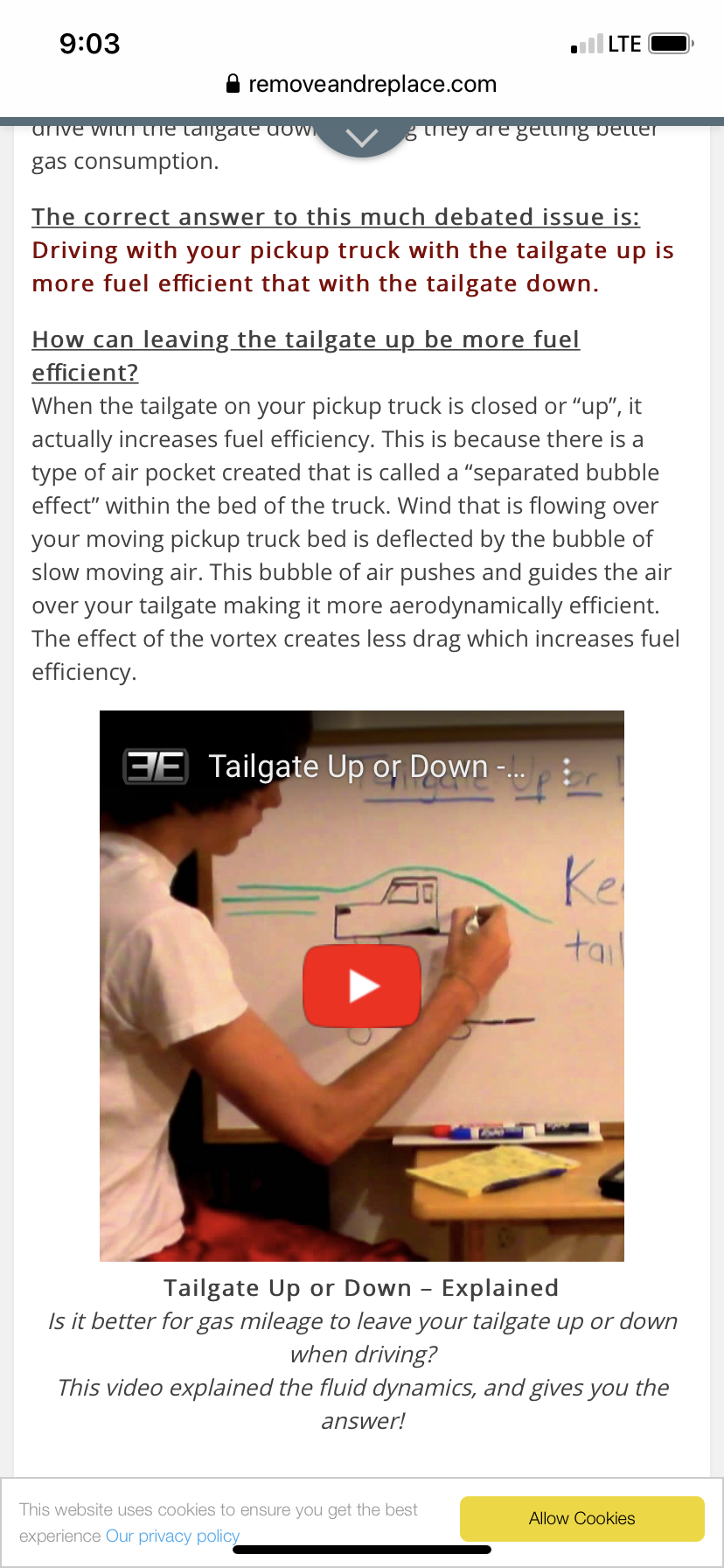

It has been proved time and again that it is actually more aerodynamic and you get better mpg with the tailgate up in place. Creates the right wind turbulence. When the gate is down or not there [net] the aero is all off and creates more drag with the end result of worse fuel mileage. Now a bed cover is a different story but the added fuel economy is probably offset mostly by the added weight of a hard cover anyway.
I didn’t know that. Very interesting. Do you have any sources on the worse fuel mileage? I’m not saying you’re wrong I would just like to see it for myself before I start telling people that.
Did a quick google and this was the first thing that popped up. Seen it in many places but the first i remember was myth busters way back in the day. There is a video in the link i provided too.
https://removeandreplace.com/2015/07/28/does-a-pickup-truck-get-better-gas-mileage-with-the-tailgate-up-or-down/
Edited by smrr1
I thought the Mythbusters found that it was most fuel efficient to take the tailgate off and put one of those mesh nets on because you lose the weight of the tailgate while maintaining the aerodynamic efficiencies. But it was a long time ago so I could be misremembering. And that's not what OP was really asking about.
