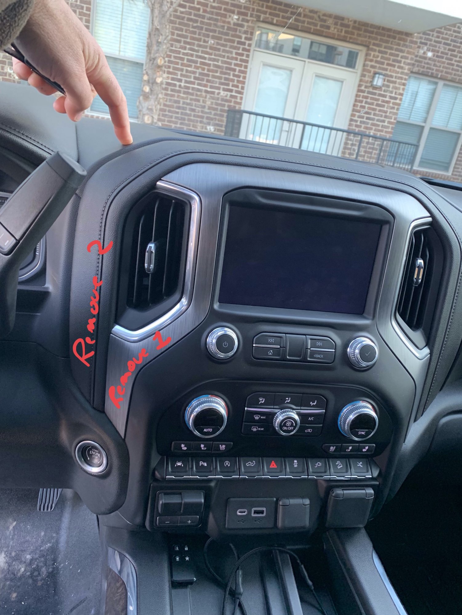

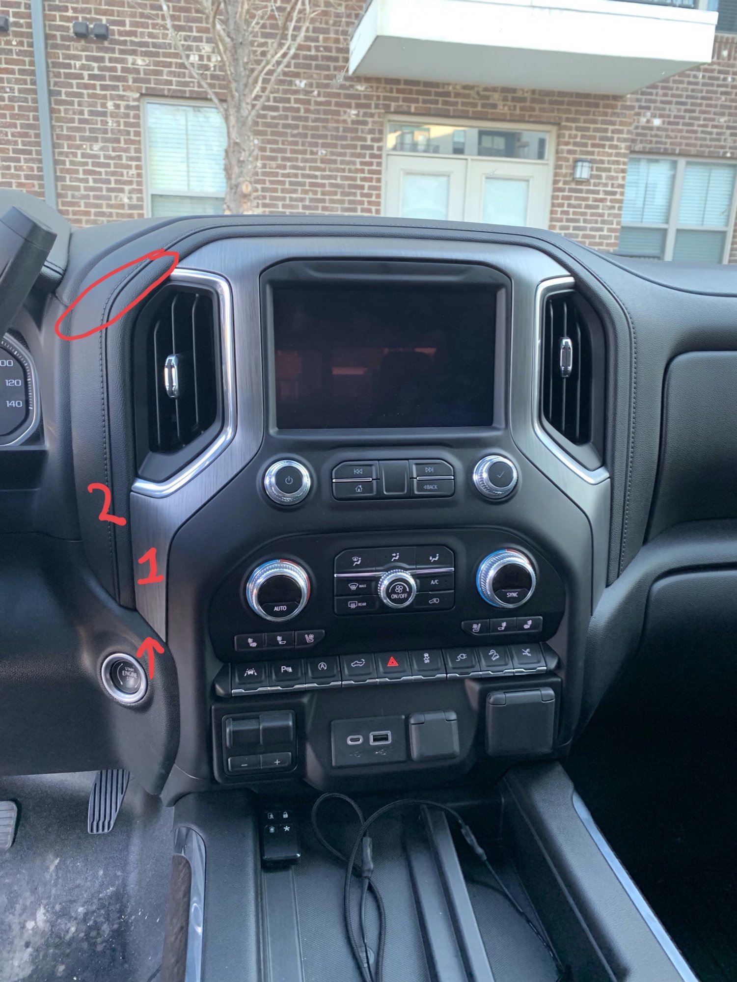

I’ll get a pic tomorrow and post where my squeak was. The dealer fixed first round but came back elsewhere .  .  But I did Have to pull back the info system.  Wasn’t bad though. I’ll label pic best as can.

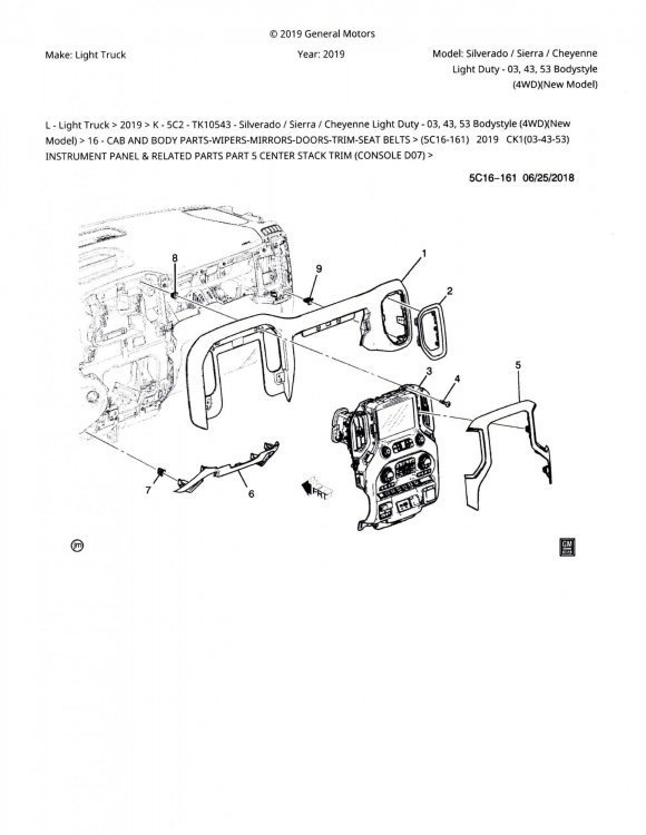

Silver trim remove first with flat bar. It pops off. Then the other trim pulls straight off as well. This will expose screws that should be taped or grease added.  The info system screws have to be removed and it will lean out exposing screw behind it. That was the one giving me a problem.  To get info system to lean out enough may have to remove the side panel of floor console, it has one screw then pulls straight out. Passenger side pulls straight out.  Then cup holders storage in center pulls straight up.  It all pops in and out but does take some force.
When the info system leans out there was one screw about where my finger was making the squeak noise.  I worked On the screw  and it helped but I think Ultimately it was the actual dash skin rubbing on some metal under it. I was Able to squeeze my finger between the two and add some insulation and haven’t heard a squeak since.
Id push on every screw visible until they are all gone. Hope this helps.
The number 2 piece I only Popped off enough to pull it back and access screws. I didnt Take it all the way off. On the center console pieces I popped Off the wood trims to prevent them from being scratched.

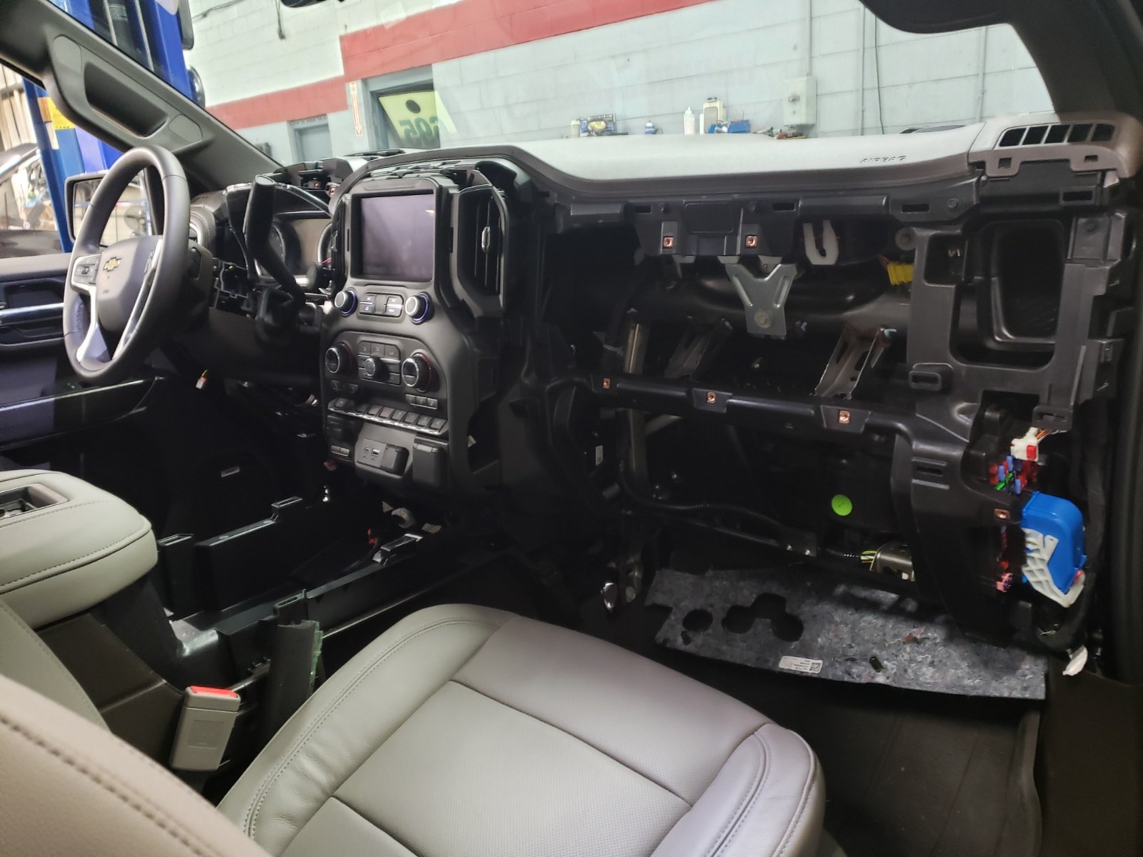

This is a pic of my truck when it was disassembled while looking for squeak that was actually outside the cab.  Maybe it will help.  Amazingly the dealer put it back together without any new squeaks.
