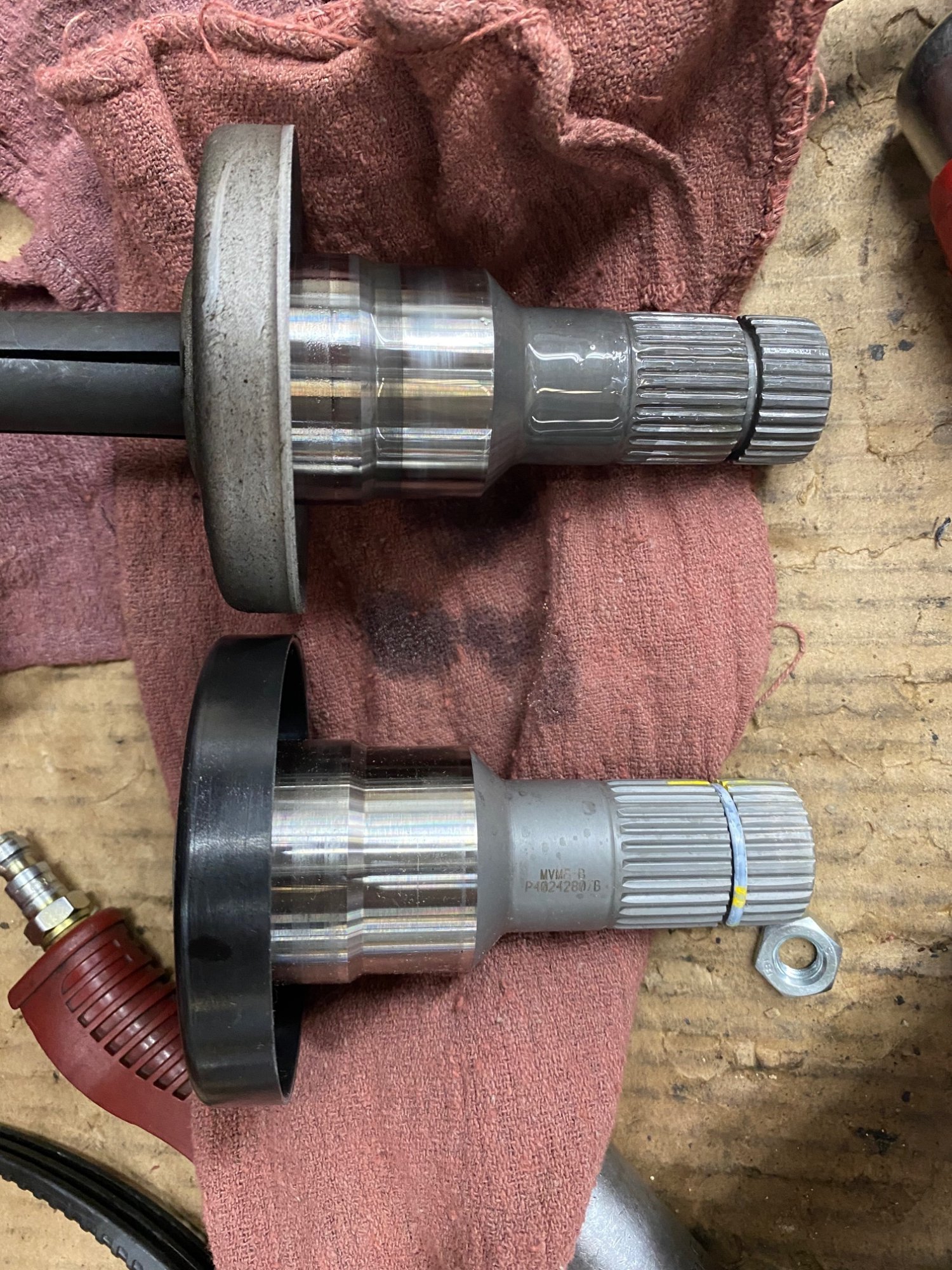

Alright, from what I can tell is the metal slinger that covers the bearing is now made of a polycarbonate or plastic material. It also looks like it was glued to the stub shaft as well. I think the logic here is that the metal one was resonating as the stub shaft shifted which caused the noise. You can see the "wear ring" on the inside of the metal slinger which is where I believe it was rubbing on the housing.
I will try to keep updating this as I continue to drive more.
Edit: I would like to also add that whole looking back old photos, the clip that fits on the stub shaft "looks" bigger on the new one than the old one did.
Edited by Otherguy
  • Thanks 2

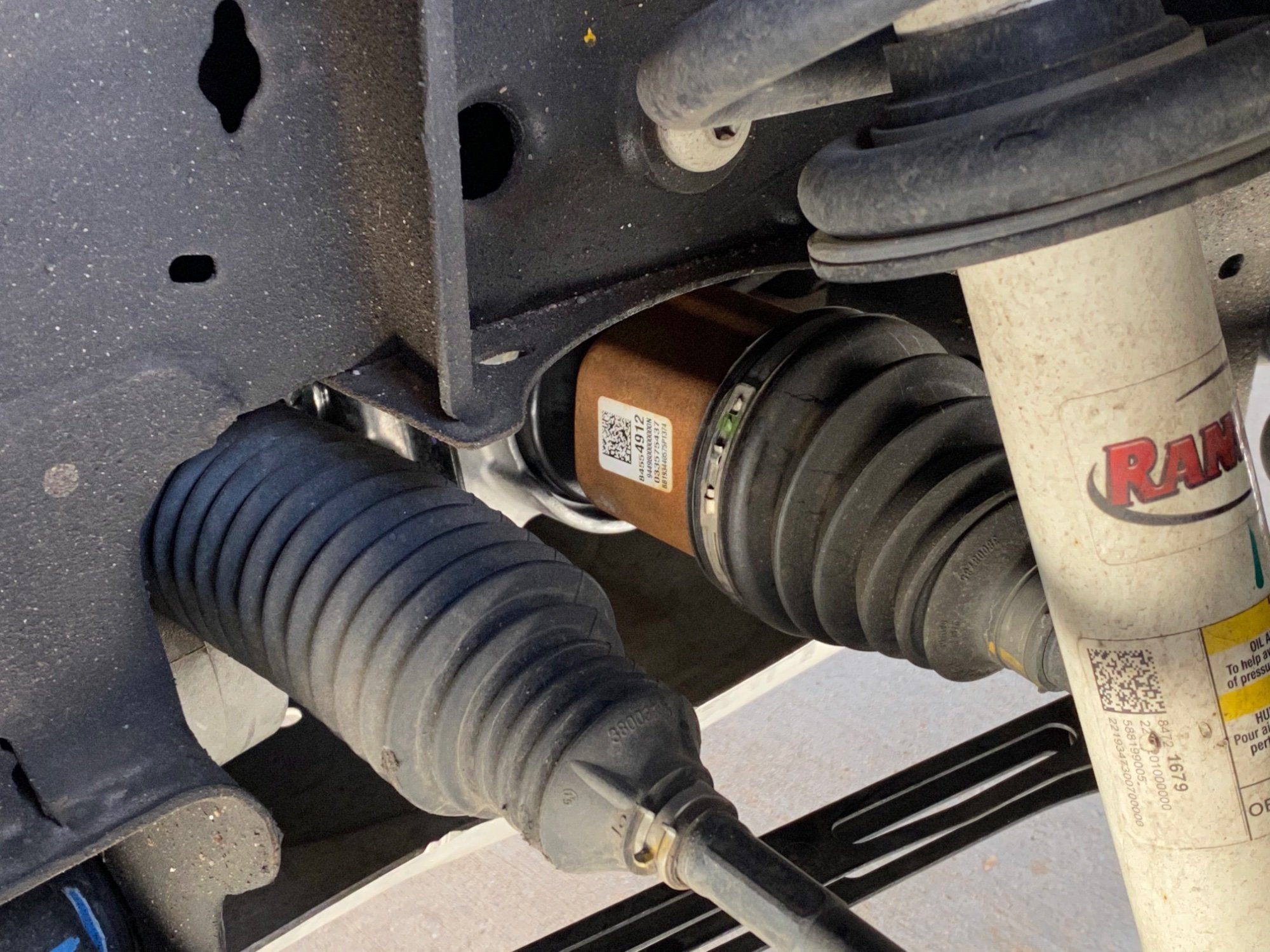

5 hours ago, AJMBLAZER said:
Trying to picture it. You can’t see that from the outside at all, right?
Just wondering what they did to mine.
Edit, you can see the slinger just by looking. See attached photo.
Edited by Otherguy
Thank you for the pics!!
This makes sense from a materials perspective as the "jingle jingle" noise definitely sounds similar to a metal on metal contact.  Change to a dissimilar material like polycarbonate and it eliminates the resonance.
I just wonder why it is only the DRV side as I would think the PGR side stub shaft would have similar material and design.  There must be a dimensional difference or an angle difference from side to side.
Either way, I have shared these pics with my dealership as we wait for part arrival.  Hopefully they can get me in soon so I can have a noise free summer.

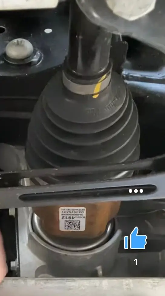

Well, looked at mine and confirmed it is a metal dust cover. Not sure what they did correctly on mine but so far, so good.
As I posted somewhere back in this thread, mine has quit making the noise. I even used electronic hearing protection to amplify the sound, just to make sure. And now, looking at the pic's just posted, I'm guessing with constant metal to metal wear, mine just wore down on its own. Warm weather should be here soon, and I'll listen for it again.

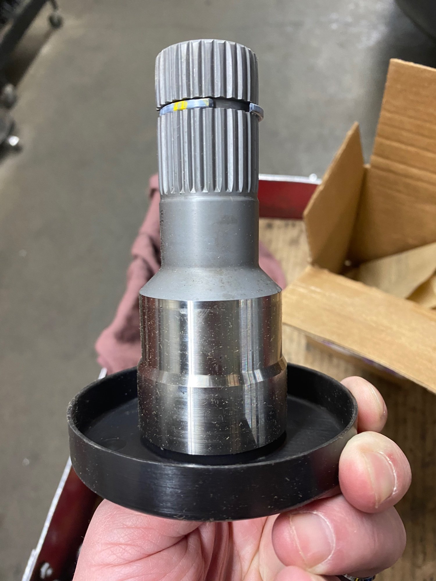

On 4/11/2022 at 10:50 AM, Otherguy said:
New stub shaft pic, I'm waiting for the tear down to compare the different parts. Truck just got on the lift.
Do you happen to know the new part number? My dealers have an issue with saying they’ve never heard of the problem or tsb 🙄
