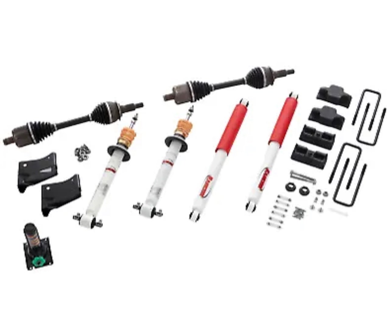

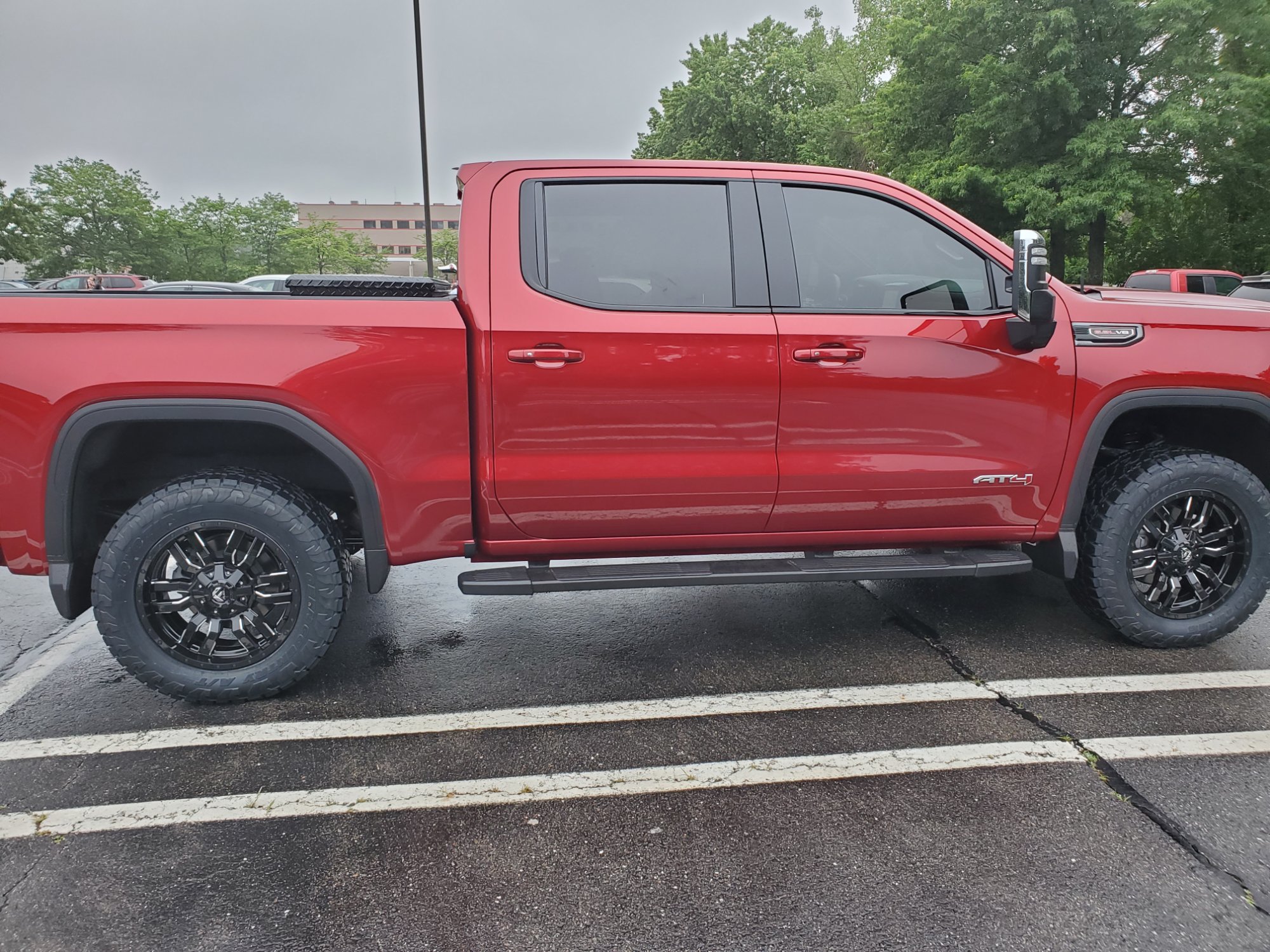

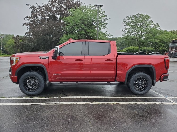

Went with the Fuel Sledge 20" X 9" +1 offset gloss black/milled wheel and the Toyo open country AT3 285/60R20 tire. Put the bilstein front coil/strut kit up front which leveled the truck off almost perfect and the bilstein rear shocks which took away that back end bounce feeling over bumps.No trimming at all needed, I get a very slight rub at full turn in reverse on the front splash guard and just barely.....but these are the bigger GMC splash guards. Im going to try to swap the front splash guards back out with the ones that came with the truck to see if it helps, if not I might try those gatorguard mud flaps. Also this setup cleared the A-arm with plenty of clearance.  I have about 3/4" to 1" of poke which is perfect and not to aggressive.
I definitely feel like with the bilstein front strut/coil kit which brings it up 1.2" in the front on the #3 circlip setting that a 285/60R20 tire is the max you could do without getting into trimming or having major rubbing. I am very impressed with the toyo open country AT3 tires....they are meaty for an all terrain tire and very quiet. I found the sweet spot is 38 PSI on my truck to run.....toyo recomend 40 to 42 but they rode stiffer at 42.
Here are a few picures of the outcome
