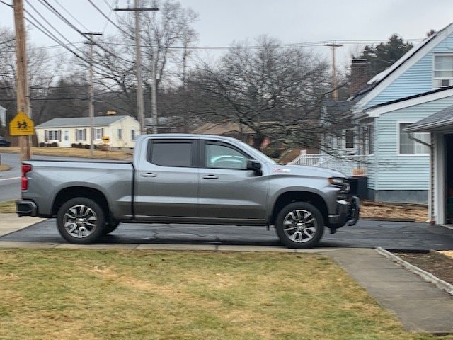

Just got back from the Chevy dealer from my alignment . I install the Motofab 1.5 leveling lower spacer. 2 inch would have been to much. She now measures 39 inch's at all the fenders. Accept the drivers side 39.375. It was a litle higher to start with. When I was waiting at the dealer I measured a Trail boss with the 20 inch wheels. It measured 40 inch's front fenders. Still like a little rake. might install a small block in back for a 1 inch lift. At full droop or articulation. The boot come very close to the shock. This wouldn't be the ideal set up for heavy Off roading . Dont plan on it any way. Love the look and the truck.
Yes now the front end of the truck is now level with the back. Trucks come higher in the rear called rake to offset any weight loaded in the bed of the truck. Or towing at trailer. Putting a lot  of weight in the bed of a leveled truck. The nose of the truck points towards the sky. But If you don't load up heavy often it's no big deal.

Truck looks great. Was i my garage and I remembered I had the stock rear blocks from my 2009 with the u-bolts in great shape . They measure 1.2 inch's . Should be perfect to put some small rake in the back of the truck with the Motofab 1.5 front. Will post some pictures when I install them.
