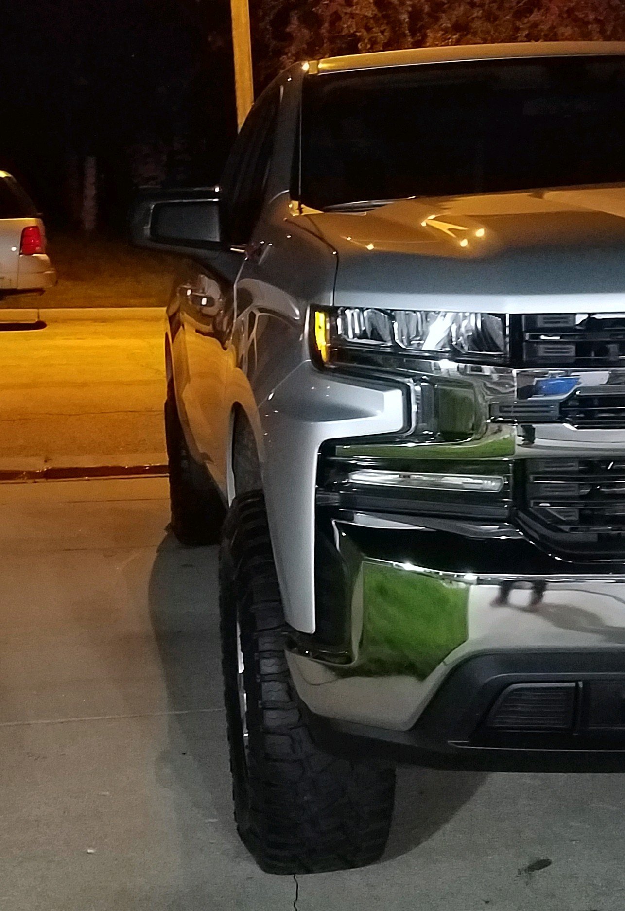

2.5" level kit and 1" wheel spacer up front.
Rear left stock.
OEM LT rims with 35x12.5's
Look great! Any rubbing issues with the 35s? Did you use the spacers for clearance issues or just for looks?
Sent from my ONEPLUS A6013 using Tapatalk
Rubbing? Oh yeah! The spacers were needed for clearance at the upper control arm. Could've got by with 1/2" but I wanted the front out a little bit. Along with that and the front only lift/level, I was shooting for a stance similar to the baja trucks. Without the mudflap mod, I still had only 22-23° of turn availible till I could hear rubbing. After removing the rear fender mounting bracket and pulling the inside of the mudflap to the frame rail, I get 35ish° which is almost full lock.

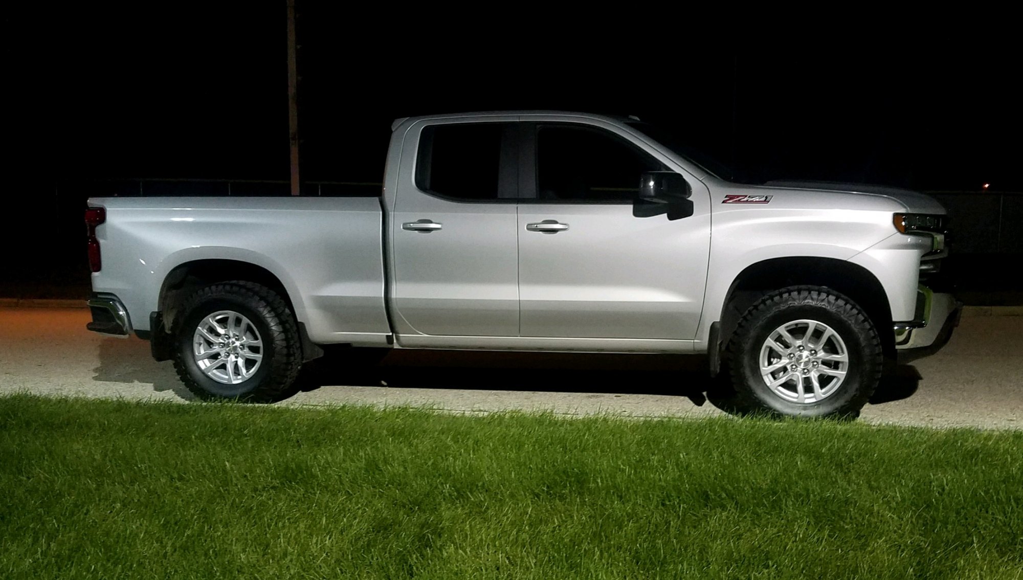

2” Motofab up front. 2” Motofab blocks on rear.
(I like a little rake)
Cooper Discoverer ATP 275/60R20

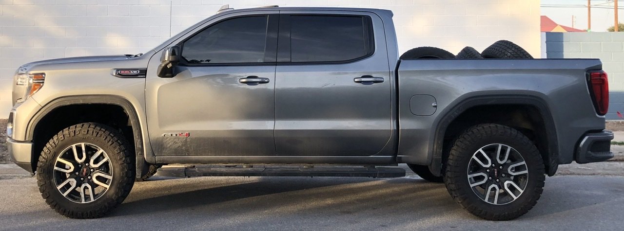

Replaced the OEM Bridgestone Duelers for 35” Nitto Ridge Grapplers. 2” RC AT4 leveling kit. Zero rub.
Are those 11.50’s or 12.50’s?
How does the ride and handle compare to the OEM duelers? I have an older Tahoe that rides like crap since I added 10 ply tires...wanna avoid that mistake with my new truck...
