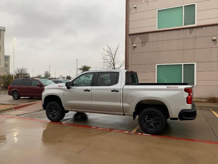

Truck leveled - Ready Lift SST kit - before and after - before front was 38" +/- (ground to bottom of fender flare) and rear was 40" - now 40 1/4" front and 40.5" rear - IMG_8517.thumb.JPG.38d252b07836d47adc33eeaf1e981be6.JPG610637760_LeveledTruck.thumb.jpg.f78160af86ffe0dc95d36b2da9fe85d6.jpg1306991748_Methods1.thumb.JPG.cb55f8749df4625801514b7a8e1b197c.JPG
Added Black Method NV wheels 18" x 9" as well

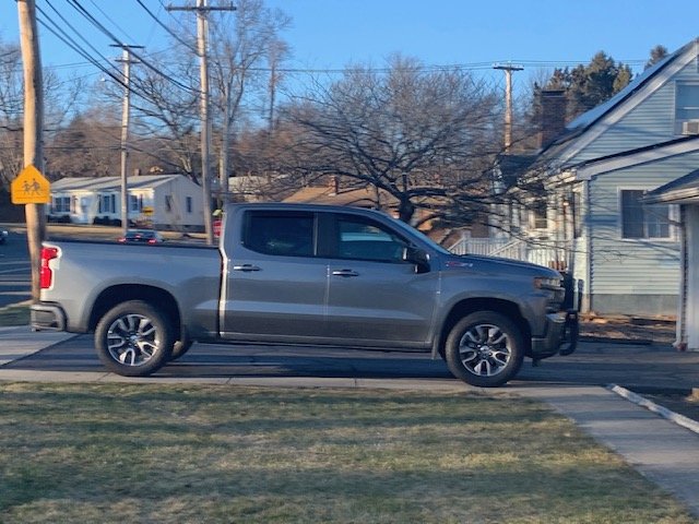

Yeah You truck looks great Lapoolboy. Im sure it's tall. I test drove a LT trail boss before I bought my 2020 RST. I remember the bed was up to my neck. I"m happy with the 1.5 level in front and 1.25 in the rear. 1.5 shouldn't tax the front end components to much either.  It's just right. Still might get those Rought Country Leveling struts some day. Until then I'm good.
