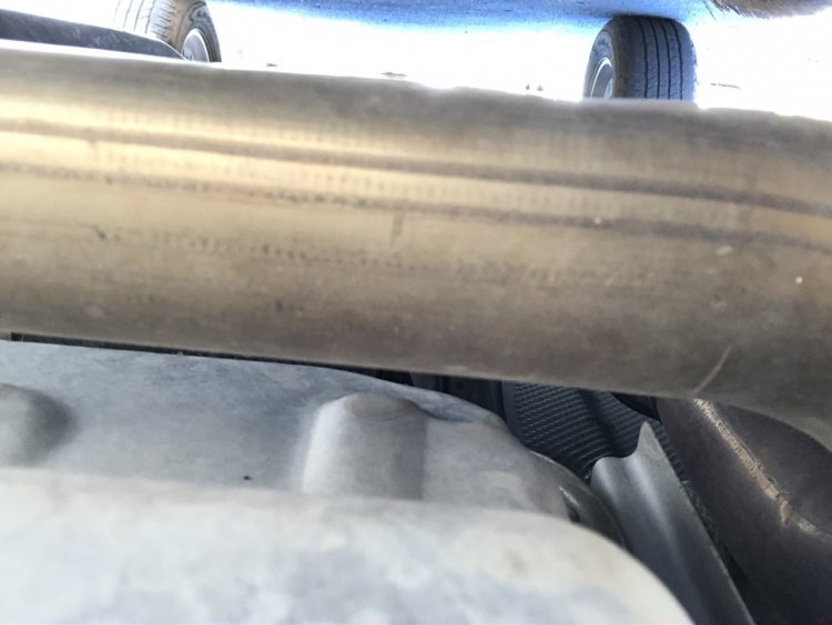

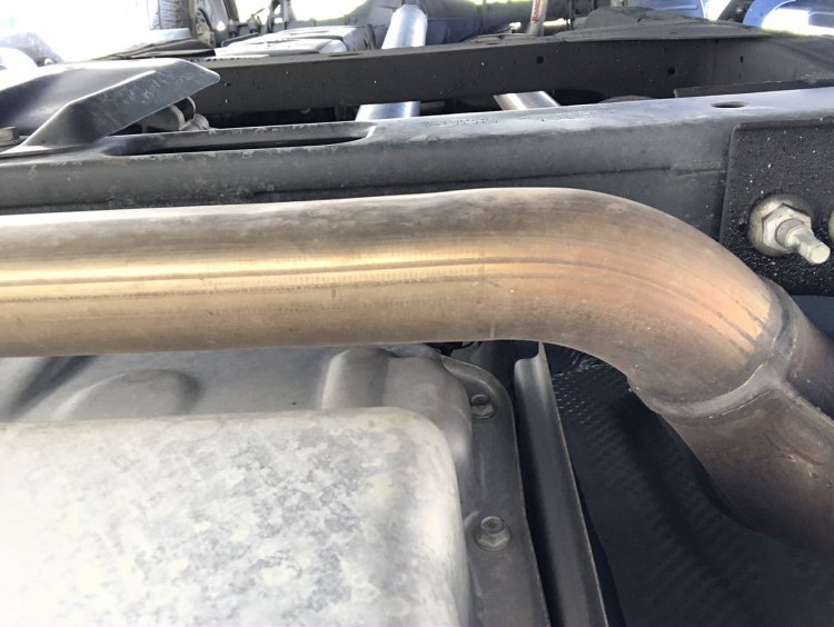

do I need to drop exhaust to drop pan or not? Crawled under and took pics it looks like there is clearance...

You can get the pan out without messing with exhaust it is just difficult and you spill fluid. Only down side on aftermarket pan is clearance, cost, and guessing fluid amount.

If you have a vacuum pump shove it down the dipstick tube and siphon out as much fluid as you possibly can to minimize the mess. What I did was remove all the bolts holding the pan on the tranny and then I lowered the pan slightly to break the pan loose from the gasket. Then spin the gasket around so it is no longer touching the pan towards the rear of the truck (near that damn exhaust cross pipe) and then put the pan up in the rear and wiggle it past the filter. Just take your time and you will get it down just be prepared to get messy, put down cardboard to save your driveway if you are worried about it.
I put a bottle jack on a piece of 6x6 cribbing under the trans crossmember, with a ratchet strap around the exhaust and under the 6x6. The jack creates an anchor point. Then I cranked the ratchet strap to pull down the exhaust pipe a little bit. I got as much fluid as possible out of the pan by dropping one side, didn’t get anything on the driveway. Then I drilled a hole in the pan, and took a cut off wheel to a nut to castle it and welded it to the inside of the pan. Installed a standard GM trans drain plug (off a Colorado I think) with gasket. Drain/fills have become stupid easy and quick.
this is what you do, take all the bolts out of the pan, take a pry bar and pry down on the exhaust a the back side of the pan and it will move enough to squeeze the pan out.
sometimes this is hard to do as one person so another hand will be helpful.
