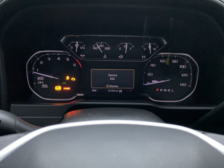

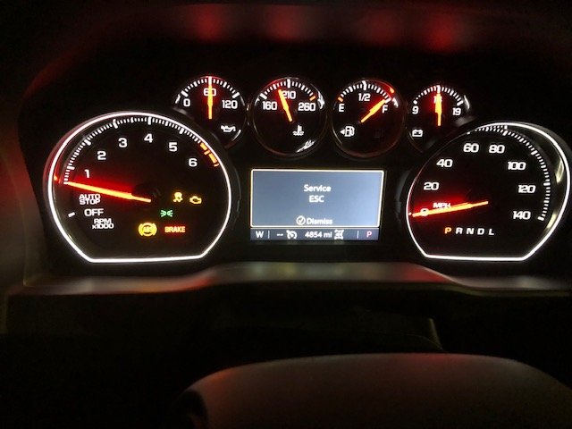

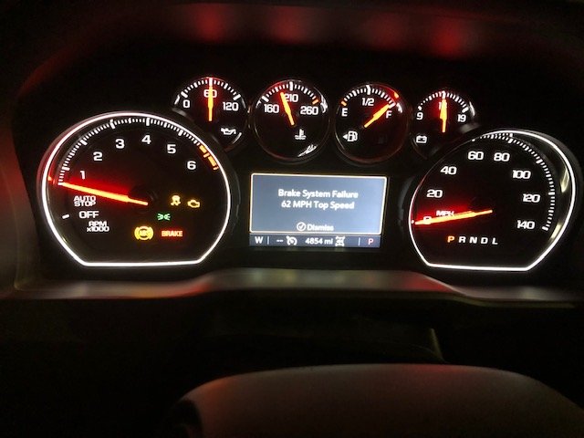

Mine has done the brake system failure three times now, first time the dealer replaced the master cylinder, it made it 10 months and did it again, this time they said the brake control module needed to be reprogramed, made it 1 month this time. Every time that it happened it would start working either after driving for a short distance and shutting vehicle off or driving home and then the next day maybe the check engine light would be the only thing on and by the end of day that would be out too. Just did it again this past week, not even going to take it in this time as it has reset itself and my new one should be here in another month. As far as having to get towed I just drove home carefully, doesn't hurt anything, you still have some brake, just not power brakes as we are used to. Now if I lived in a high traffic area I would be much more concerned as you are not going to be able to stop abruptly if the need did arise. These pics are from the first time it did it.
