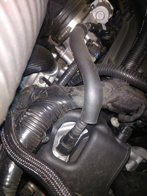

Just received my JLT can. The directions dont match my 6.2  My hose appears to be right up front. It couldnt be any easier.
 Is that the correct hose? pic attached.
