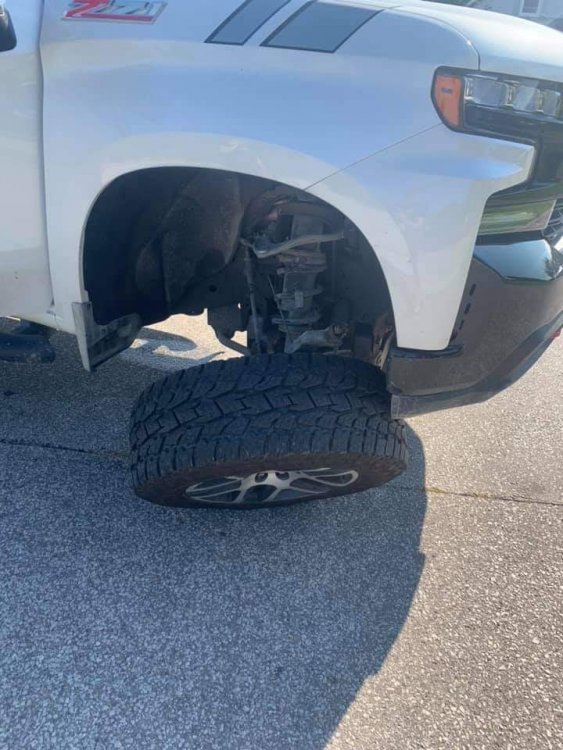

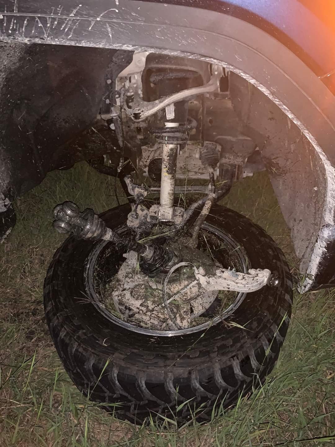

There are so many on Facebook with problems with those arms from everything besides stock. Most of it tho is with the bigger tire like 35s.  If you never seen how bad a blown upper ball joint or one ripped off the arm looks you might want to. If it was me it would be a piece of mind to just do ucas.
got a link to pics...thanks
