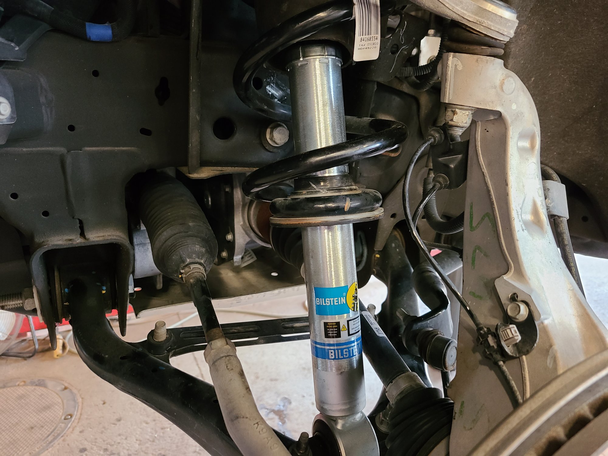

I always have a bad case of scope creep so  I ended up with front 6112’s and rear 5160’s instead of 5100’s all around. Was going to get King 2.5’s but the wait was just way too long for me.
The Bilsteins accomplished EXACTLY what I was wanting. I couldn’t be happier with them and I’m happier every time I drive my truck. My wife even commented how much better the ride felt to her.
These replaced the OEM Z71 Ranchos. I was unhappy with how they felt over the pot holes, rough road sections, and speed bumps I encounter every day. The Bilsteins feel much better going over these. As well as much better on the highway in sections when the truck would previously feel “floaty”. The truck now settles quicker and I feel more in control. They are firmer which accomplishes this however they are NOT stiff at all.
Is the Bilstein hype real? I would answer that with a resounding yes.
