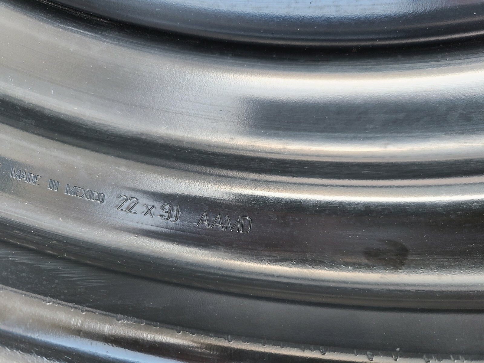

These are the 22" transport wheels that GM uses, still trying to find a 20" version.
You can pick up a set of 4 for around $900.00 on eBay.
Image 51 - 22” GM Transport OEM factory wheels Transit steel black rims GMC Cadillac chevy
Image 01 - 22” GM Transport OEM factory wheels Transit steel black rims GMC Cadillac chevy

Also, stay away from GM transport wheels.  They are NOT supposed to even be re-sold as they are not DOT road worthy.  GM has a $1500 core on them that they charge the dealers.
