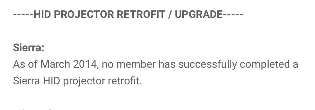

Just wondering if anyone has finally done a successful retrofit on a 2014 Sierra. I sure would like to upgrade these horrible headlights.
Yes. I have a 2014 Sierra and upgraded the projector along with installing HIDs.
Thanks for the replies. Its 2019 and Im sure someone has had a retro kit installed for at least a year. If so Id like to to know your pros and cons or at the very least what kit you bought. Trying to search for terms like D2S and FXR3 brings up tons of results and it just gets confusing. I just want to upgrade the stock headlights to something I can see the road with. Ideally with OEM reliability. DM me if you need to but I will be most grateful either way.
