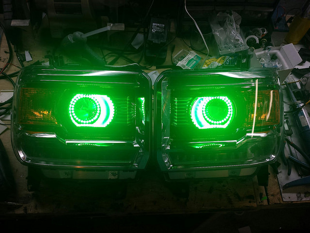

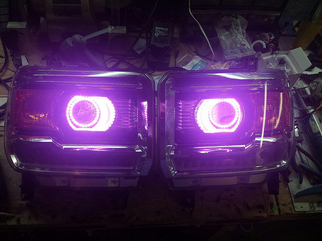

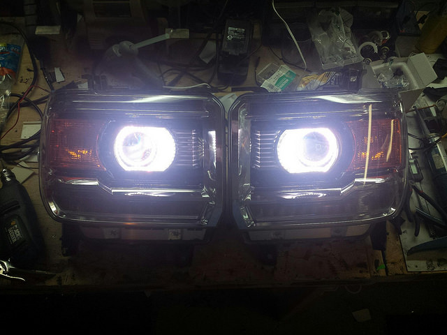

Here is some progress on my headlights. Fastheadlights LLC is performing the install of the FX-R Stage III Kit and the RGB Halos.
Where did you get the halos from? And how are they controlled. I am thinking of getting some RGB halos and getting my light bar so that it can have a multicolor back glow. Have seen one guy on Instagram who had his LED DRLs retrofitted so that they would change color with the halos and he had a 50" light bar that did the same.

Fast headlights LLC did my head lights. I went to there site and told them what I wanted. They are good guys and do quality work. They did the HID projector retrofit as well. You might be able to google the halo company and order them by size. I'm sure they know which halos fit per car/truck model because it's pretty popular in the mod if you want to do it install urself. I'll reach out to fastheadlights as well and let you know.
