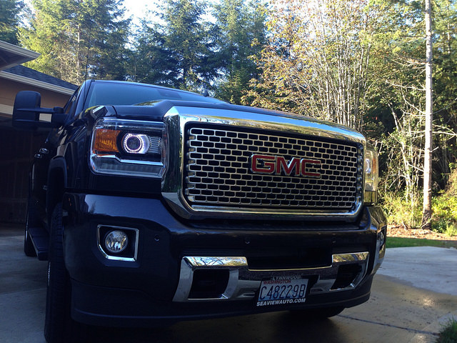

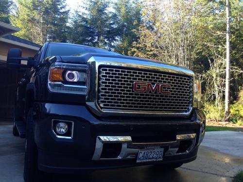

I got my headlights back from FastHeadLights. They did an outstanding job of adding the FX-R Stage III projectors and LEDs while maintaining the OEM look. I couldn't even tell that my headlights were taken apart. You can hardly notice the LED halo rings when there turned off. I did not have to level my headlight either. Lighting is 3 times better IMO at night. Very helpful fellas, they are.
Edited by JaronM3
Where r the rings from? Oracle or some other brand? Jc
You guys not having issue with moisture
In the lens?
In the lens?
I just installed them. I live in WA, so far they have been in 2 heavy rains and 1 carwash. No fogging at the moment.
Cool. How did they get the FX-rs in there? did they remove the clear lens or cut the back of the housing? Because it was my understanding that the OEM projector would not fit out through the hole in the back of the housing, so some cutting has to be done somewhere.
Bottom line tho, is FX-rs are great. I had them in a retro on my last truck
Have to cut the lights open and pull the whole projector assembly out. The bolt mom ting points don't even come close to lining up with the fxr even if you could fit it in the back. I will say on a positive note that we have designed and are getting made up adapter brackets. Once I have a good inventory of them I will post them up for sale. Not sure on price yet. JaronM3 has the same mountinf bracket on his that we are getting made. Stay tuned....
