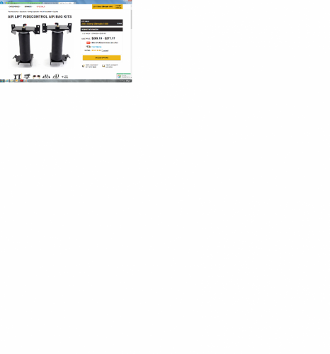

I said air ride, I meant AIR LIFT. These are the bags I installed, I use them when towing my 26' travel trailer (6000lbs). Truck sits nice and level when towing, and keeps the truck from rocking when going over bumps. but if not towing, they will raise the bed 2" but makes the rear ride like shit.
