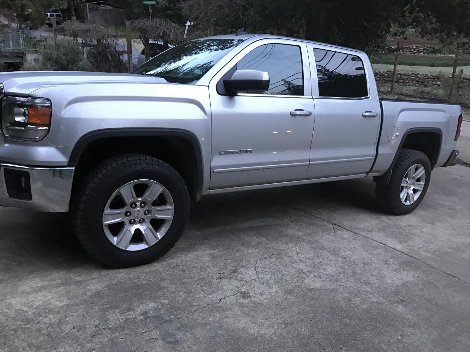

Just picked up my truck from the shop:
2014 Sierra 1500 - 2WD
2.5 inch front level
2 inch rear block
275/65/20 - Toyo Open Country A/T II
