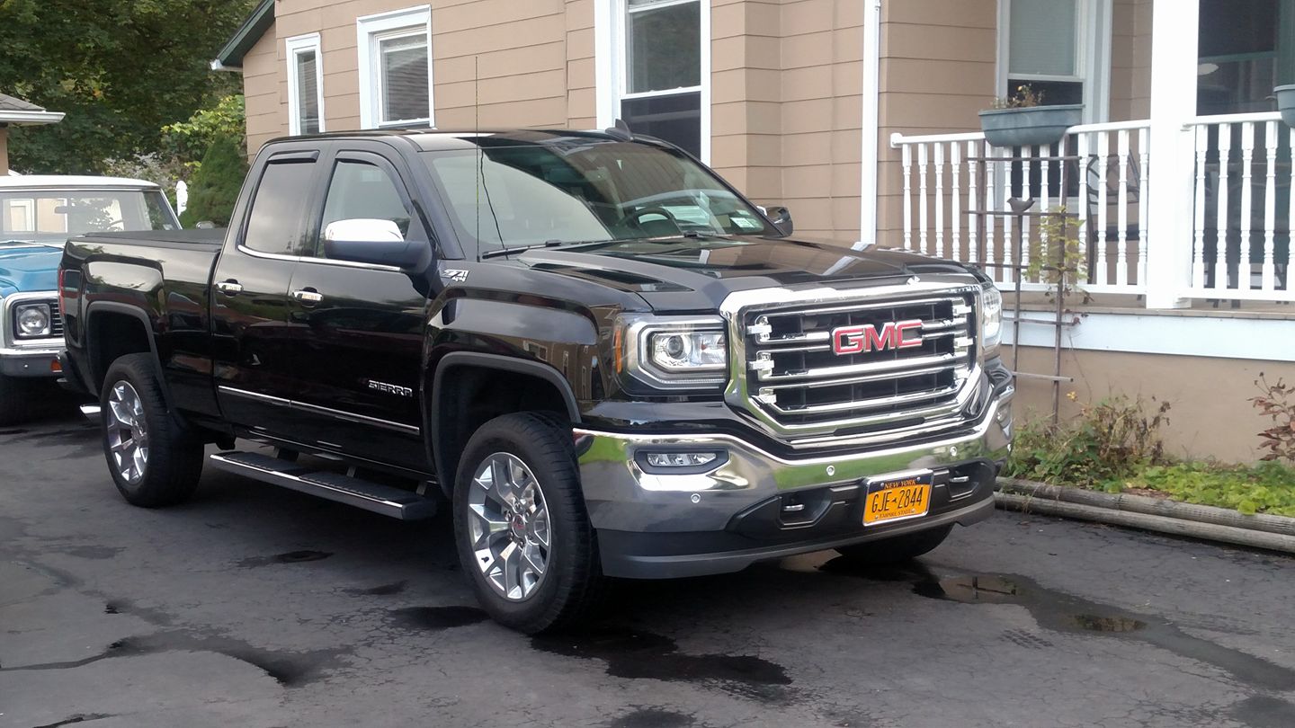

GoBlue2014LT Posted September 8, 2017 Posted September 8, 2017 Installed the 2.5" motofab today. Still have to do the 1" rear yet Sent from my iPhone using Tapatalk 1
