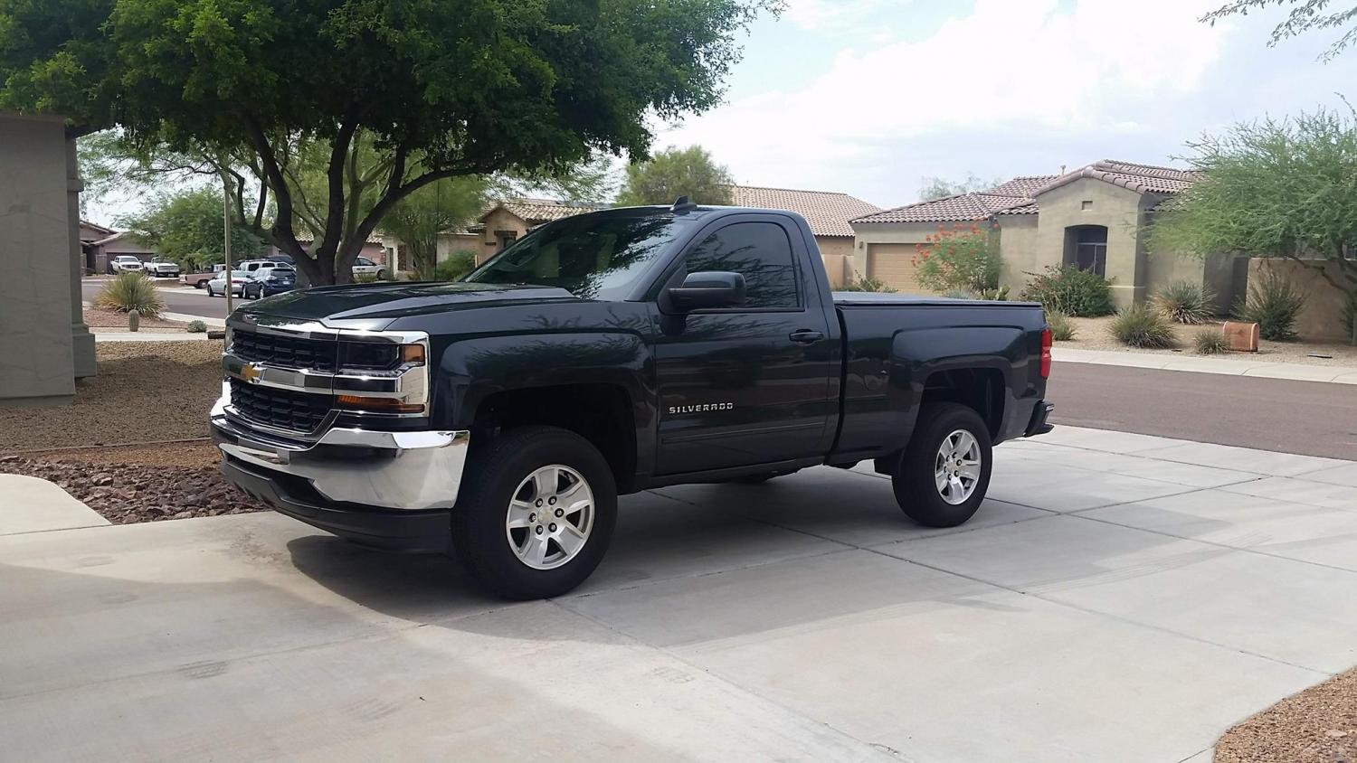

Finally installed a Motofab 2" leveling kit on my shortbed two-door. Truck still has 1-1/4" of forward bias.
Finished the level by swapping the rear blocks and getting alignment.
Stock
2.5" front level
Swapped rear blocks (1" lift)
Wheels and tires soon
Stock
2.5" front level

Came as a kit on Amazon
