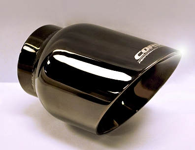

Anyone know what exhaust Lingenfelter uses on their reaper and G2? On their site it just says corsa performance exhaust, but i can't find any tips like they're using.
The only split rear tips i've seen are these.
Edited by 5RWill
The tips might not be Corsa just because the rest of the catback or muffler is Corsa. They look like just regular slash cut tips like I have.
Where can you get regular tips then? I like how it's flush with the bumper and not over extending beyond it. Also like how you can't see most of the exhaust pipe under the chassis they've got it hid well or tucked up under there.
