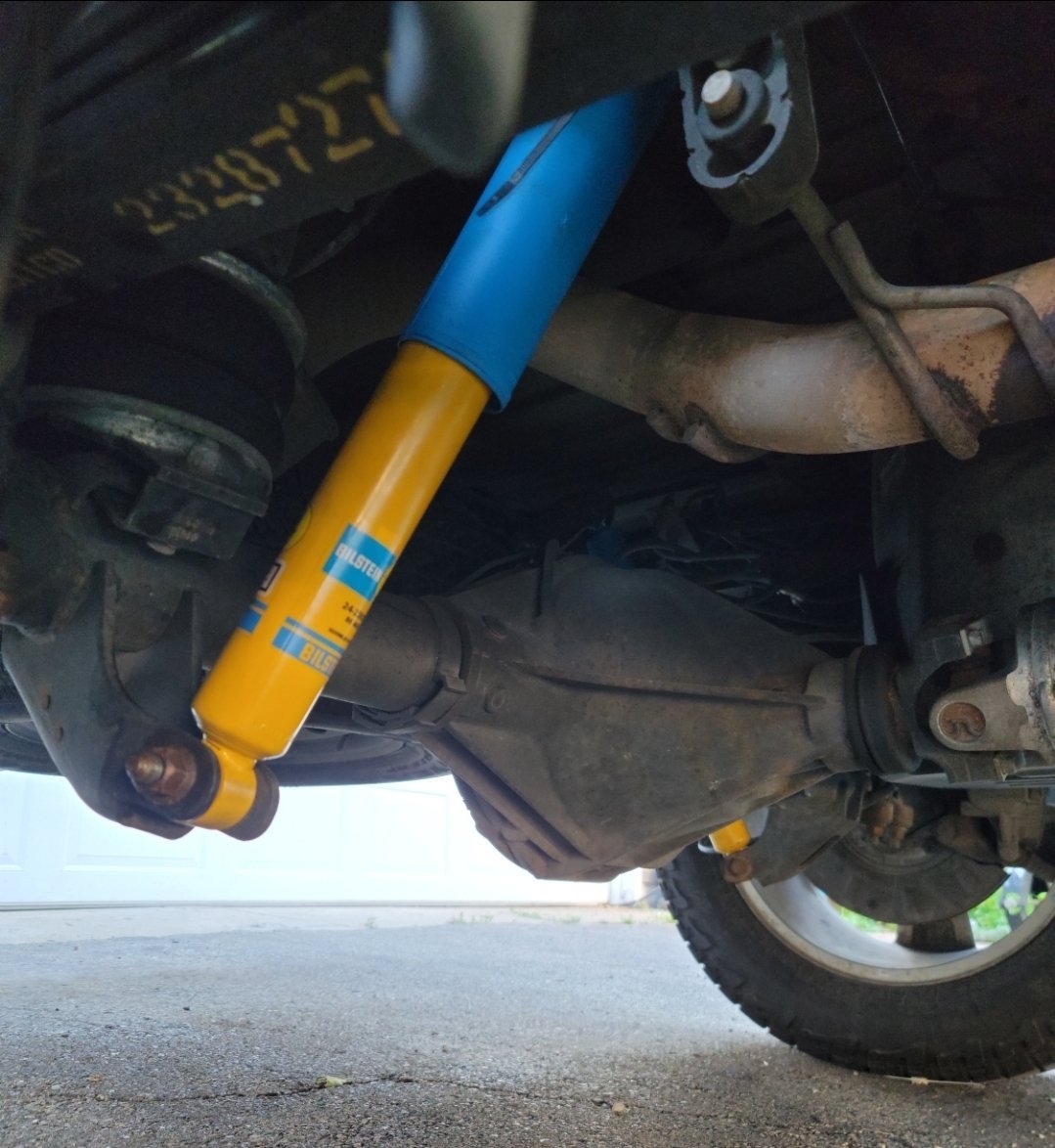

Finally upgraded my rear shocks. I went with the Bilstein 4600. I went with these because they have been recommended as a decent choice for towing. And even though I have the RC 2" level on front, I'm still stock height on the rear. I figure at about 6 years old and 74k in miles, it was time to change them out. It was stupid easy. I sprayed some penetrating oil on bottom nut and threads and the air impact wrench took that right off. I used a 21mm socket but didn't have a 21mm wrench. I did have a  13/16" wrench which worked perfectly. Top one only needs the bolt removed, no nut. One thing to mention is that the Bilstein shocks don't come compressed so I mounted the top mount first and muscled the shock into position. After pushing shock upwards to compress it, a screwdriver under the bottom eyelet held it until I got the bolt back in. It took all of about 10 mins to get both sides done. Now I have to decide on which struts to go with. My choices are Bilstein 5100 or Rancho RS999949. I'm leaning towards the Ranchos because they are a complete strut and fully adjustable without having to remove. Either way, I can ditch the RC spacer and still be leveled...Screenshot_20220824-165158_Gallery.thumb.jpg.fa54bf4ddd61ed3d57500b8b77a3ba60.jpg
Wow, surprised to hear it's so easy. Thanks for the write up!
I didn't even have to jack it up or remove the tires. I just shimmied under the truck and got it done. As you can see, the lower mount is very accessible. I was worried about reaching the top mounting bolt but there was also more than plenty of space to get the air impact wrench up there. I didn't even need to drop the spare.

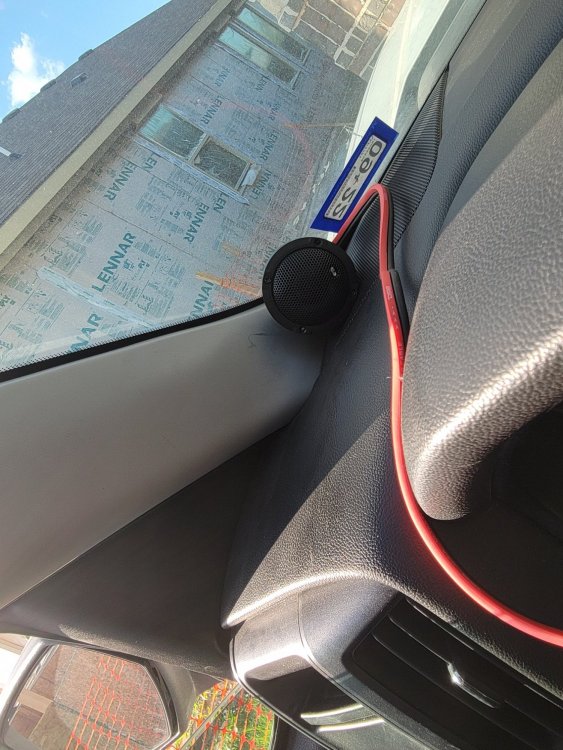

Swapped out the cdt- es-02a widebands for the Unity 7.5 widebands. Crossed @400hz/ 24db slope. I am currently trying them in pods and really liking the response. Little eq needed vs in stock locations. I would suggest anyone who put their dash speakers in the stock locations give some 2" pvc caps a shot. Night and day<plus you gain like 4-6dB in volume and clarity.
Next up tweets for a pinch of sparkle.

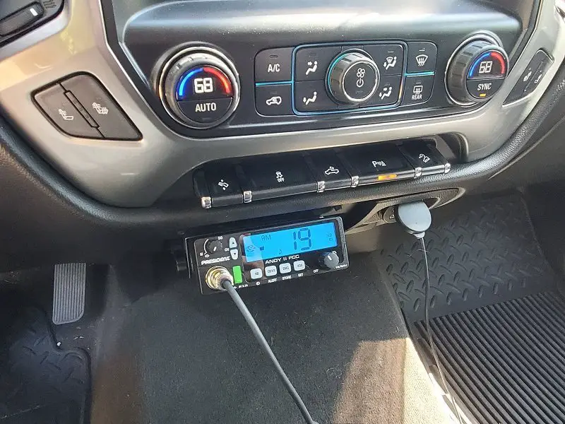

I recently got back into running a radio in my vehicle. My 1st radio was a Uniden Pro520XL I bought in 1987. I am now running a President Andy II FCC with a President Iowa antenna. Getting the mount sorted was interesting. I have a 2015 Silverado and while looking for a fender mount I found many listings for 2010-2018. In my mind, this made no sense. Body styles on GM trucks run from 2007-2013, 2014-2018, and 2019-Current. I found the proper mount from Rugged Radios but with a 3/8 NMO hole. I ordered that up and drilled the hole to 1/2". I am running a Procomm 12' Terminator series cable with an FME end.

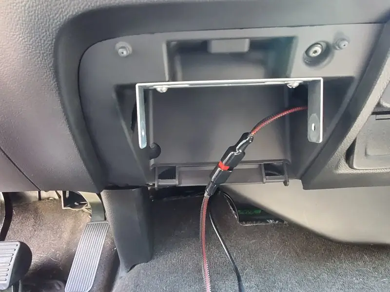

I went with the Andy II FCC because President has a good reputation and I needed a smaller radio to fit the opening left when I removed the fold-down pocket from the dash. I mounted the radio in that opening, which only required me to drill two small holes, for the bracket, that can not be seen if I ever want to take the radio out and got back to stock. I installed a combo USB/HDMI port where that 12v power outlet used to be, for the Pioneer in-dash. I tapped the unused 12v power outlet wiring behind the panel and routed it through the slot for the pocket. I wired it with some Anderson Powerpole connectors and covered the wire with PET expandable braided sleeving for added chaff protection. I am a mobile electronics installer by trade so my setup is tied into my stereo. I ran a mono 3.5mm/RCA adapter up to the radio and then used an RCA splitter into the radio. I can now set my radio to AV In and my truck's stereo is my external speaker. I can turn the CB volume all the way up and control the volume through the steering wheel controls for the stereo. I can also use Android Auto for navigation while listening to the CB or NOAA Weather. The antenna installation was easy I routed into the cabin through the upfitter provision in the main wiring harness grommet. The SWRs were low right out of the box clear across from channel 1 to 40. So far I really like this radio and setup.
