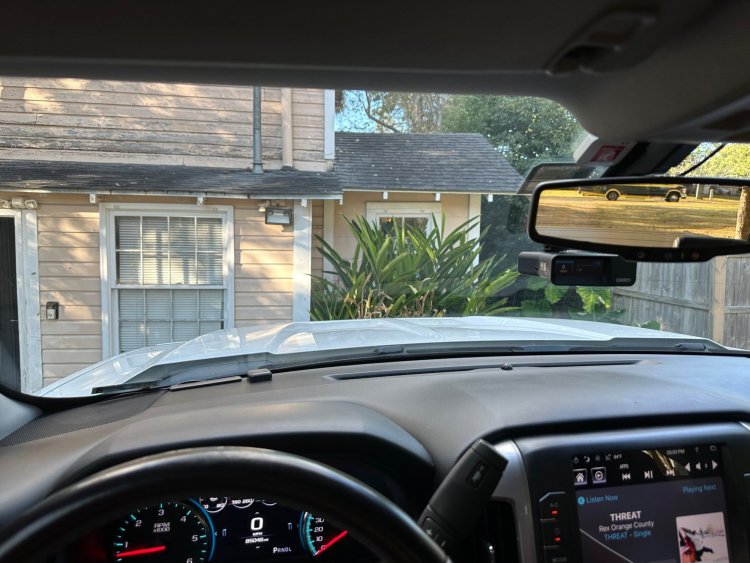

Appreciate it! Hope it's not too much to ask, but the American Trucks site site has like no pictures. Any chance we could get a view from inside the cab?
Sure. It is barely noticeable. This pic is taken from my eye level when driving.

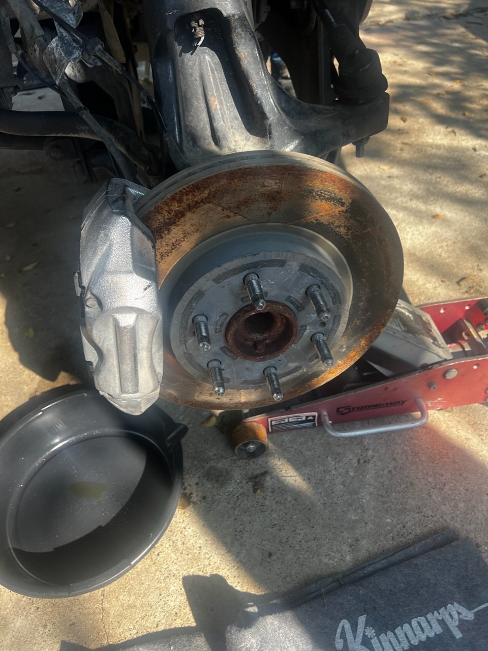

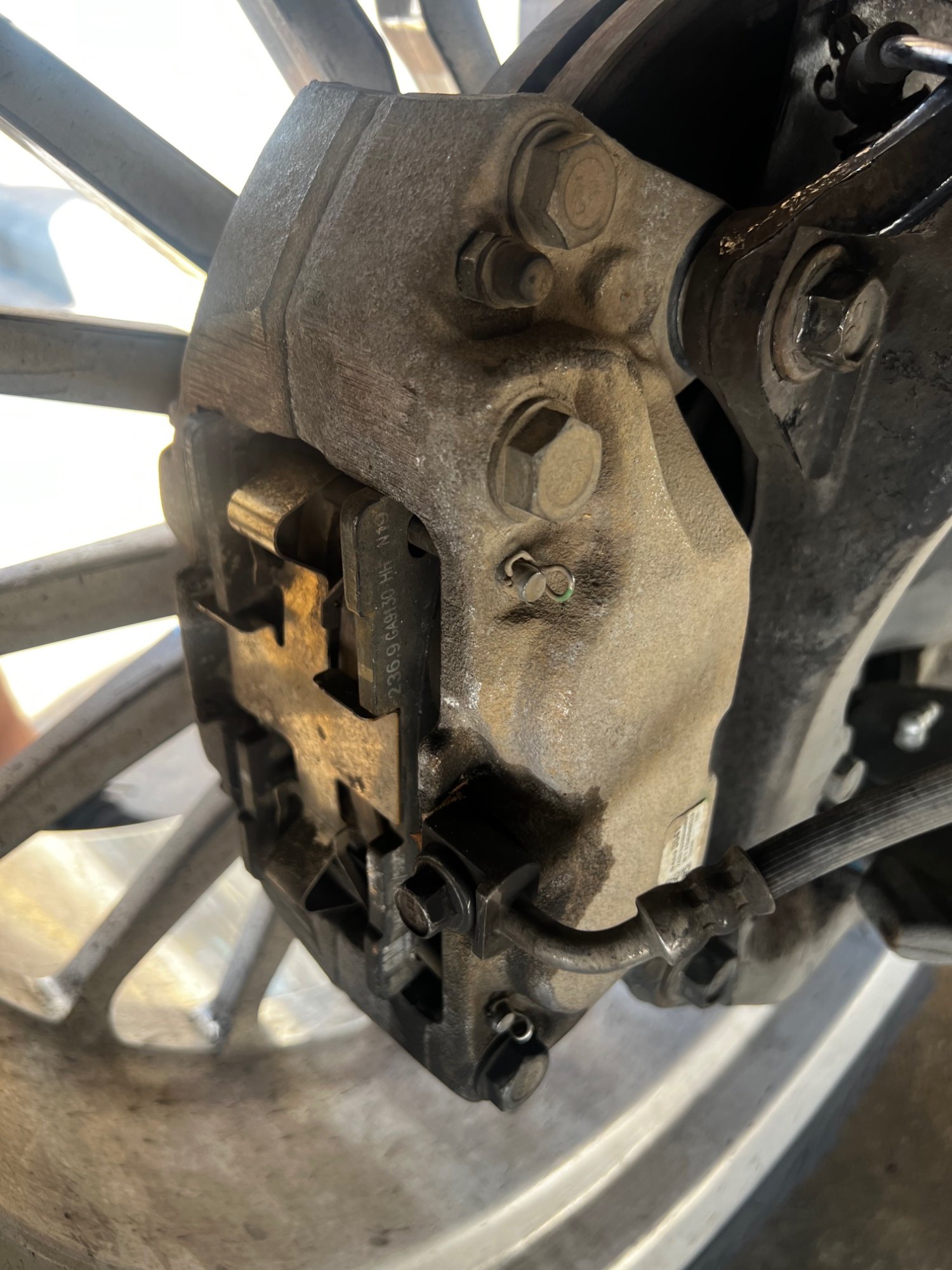

Few more thing and I’ll be done upgrading EA0056F3-AF5A-43EF-80A0-528819A5EBD3.thumb.jpeg.510bcc1edb35659fb548c3a98b12089c.jpeg
No you won't! It's a wicked sickness that has no cure, especially when you've gone as far as you have already...

Does it stop any better?
Feels like it stops better specially with these heavy wheels (also changed the rear brakes rotors and pads) and ordered new wheel lights quad flow series wheel lights 😂 forgot about that.

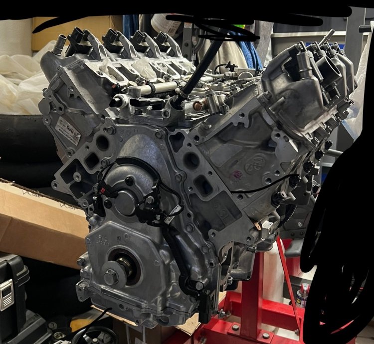

Finally got some time to put the engine back together. First round turns out the machine shop didn’t give the main bearing enough clearances and it was too tight… wiped out the bearings within 150-200 miles…. Took the block back and had them open up the clearances. Also threw in a C5R chain and Katech oil pump. Hopefully within the next few weeks, I’ll have some more time to throw it back in the truck.
Trans also got rebuilt with Circle D lvl 4 and Sonnax zip kit.
The converter also came back from circle D for a refresh and new clutches.
Driveshaft is also back from performance driveline getting balanced and looked over again.
Can’t wait to have this truck back on the road.
(Forgot to take pictures of all the goodies inside the engine. Doh)
